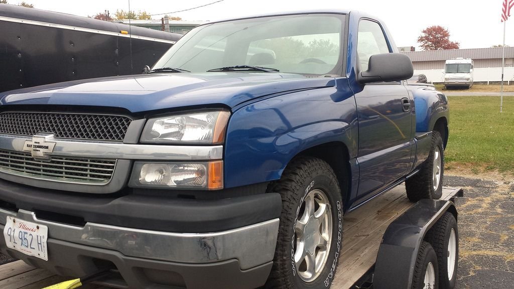

I bought this truck in 2004 with 1,800 miles on it. I used it to pull an enclosed trailer every day. The truck now has 198,000 miles and treated me great over the years. It's been sitting a while and I've always wanted to do something to it. I've finally decided to start the build.
Goal for this truck is an all around fun daily driver. A truck that stops good, turns good, and fries tires at will.
Took it to the car wash to knock some of the dust off.

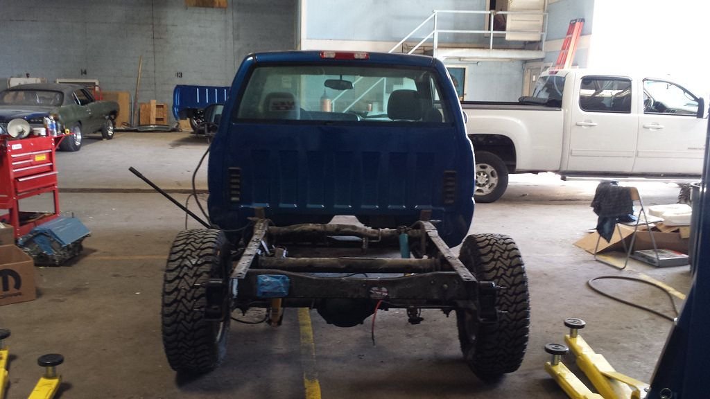

Started the tear down. Removed bed, engine, trans, brakes and lines, fuel tank, and cut out a few bars and brackets that won't be needed.
I have an aluminum fuel cell, LC9 short block, 243 heads, and a 4l80e to put in it.
I'm still trying to decide on the turbo. It needs to spool instantly and still carry the rpms well. Also trying to decide if I should do 5 lug swap, 4 link, and what brakes to use. I also plan to lower it, roll pan, SS bumper, and cowl hood.
