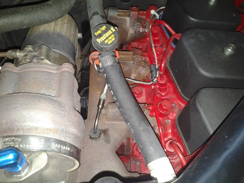

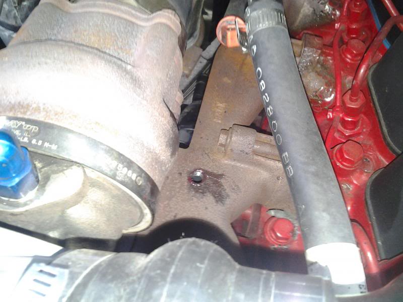

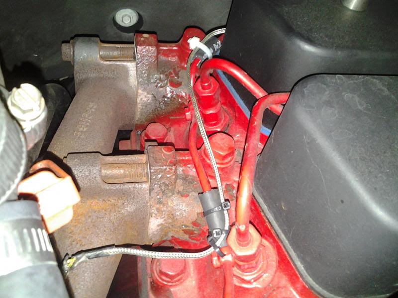

I took a little bit of time and drilled and tapped manifold for the pyro... got it all hooked up and working.
Doesn't stand out too much...
Wont know how hot things are getting til I get to put some miles on it... we'll see soon.

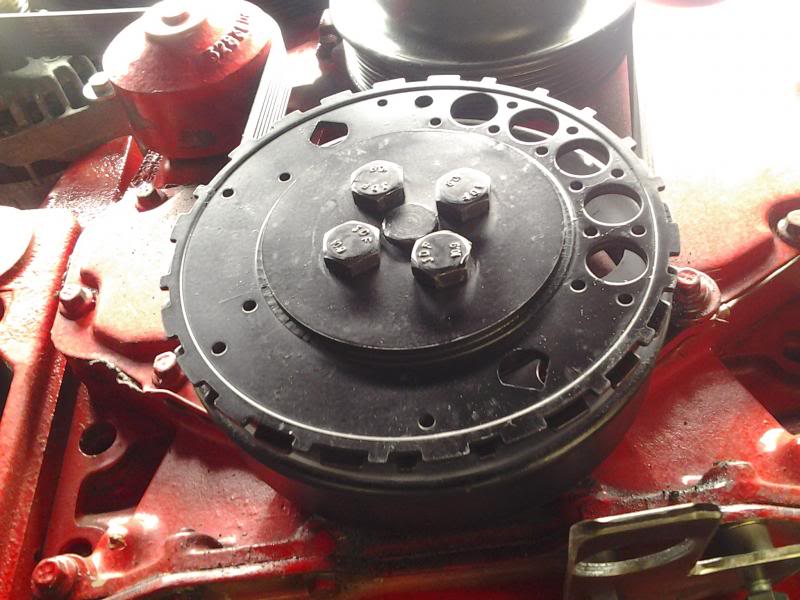

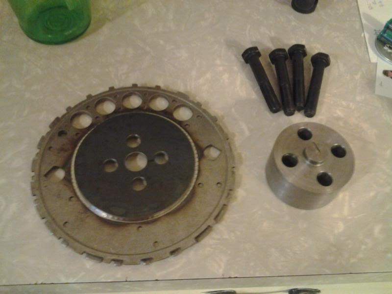

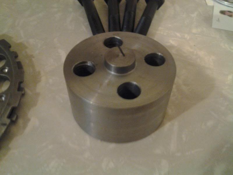

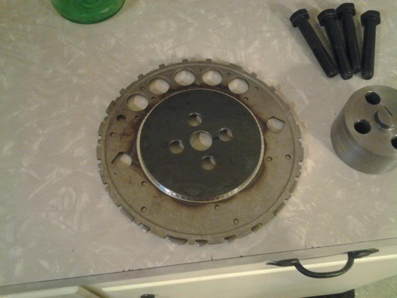

Also got the reluctor wheel done and my spacer came in... it pays to have a machinist in the family... trued everything up and punched my hole pattern... should work.

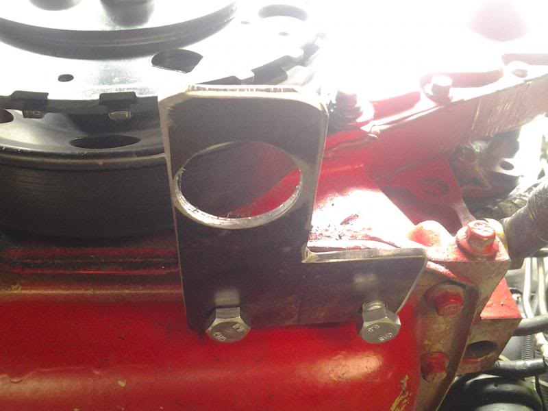

Hoping to bolt it up and build the bracket for the stock cps this weekend... hopefully that will get my tach working.

Here are some pics of the tone ring and cps mount... which I plan on changing... just had to figure out how it was going to work. I'll fab up the finished mount sometime this week.
Stock pulley...
Crank spacer and reluctor mounted...
1st mount position... would have worked nicely but the CPS didn't have enough angle to it (cps sensor is angled slightly from the factory... just not enough)
Moved it to the left 1 bolt hole and it worked perfect position wise... now I just need to make the mount wider to use both front oil pan bolts. I'm also going to pick up some longer bolts so I can space the bracket down instead of spacing the cps away from the bracket... should be pretty easy to knock out tomorrow or Tuesday.
Stock pulley...

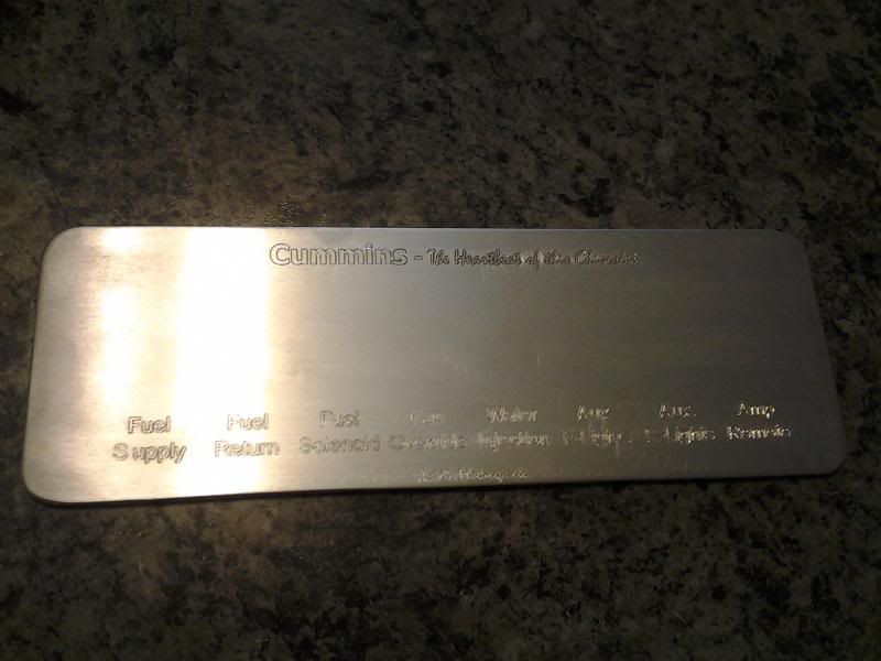

I started a switch panel and engraved it at work today... it turned out pretty slick.. which btw I've got access to the engraver at anytime and have aluminum laying around.. so if someone wanted something custom done... well.. anyways..
And this is where it will go when its finished...
Waiting to order switches to fill it... I also have since blacked out the engraving so everything is very clear to read... should turn out pretty slick when I'm done...

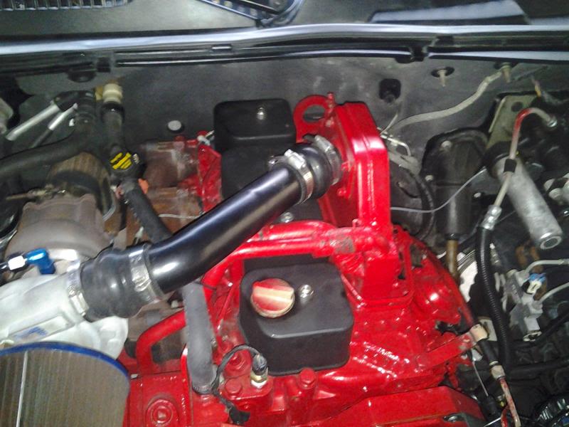

As for air to water... I've got one already... its the large trapezoid looking piece that the turbo is plumbed into... factory from cummins. It gets its water from the engine cooling system though and once its at operating temp, you can fee a power difference (drop).
Not worried about fitting the intercooler.. Ive got plenty of room to move the radiator back towards the engine a few inches and fab up new lower mounts for it... as long as the intercooler outlets will clear the radiator.
