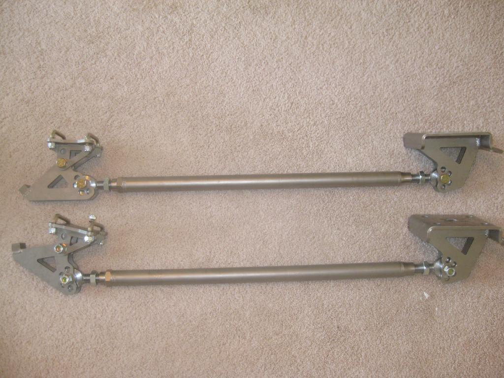

I've heard pretty good things about assassin bars as well. They do require the hole drilled in the leaf springs which I hear can be a pain. Another thing though, theyre cheaper than caltracs.

Work, the house, and funds have been making progress slow, but I have a few updates. My assassin bars came in and they're beefy! Should be able to handle my mighty 4.8 just fine...for now. Hopefully I'll have time this week or next weekend to get them installed and head back to the track for some new times.

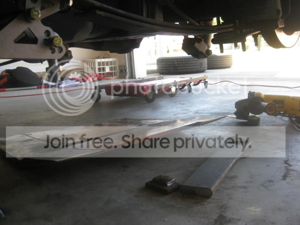

Got some work done on the truck this weekend. Didn't quite get traction bars installed. Was drilling the last hole through the leaf and my carbide bit broke. I'll get some pics of the completed install tomorrow.
Used an angle grinder with a cutoff wheel to cut the overload leaf and the 2nd leaf back a little bit. Then I hit the cut ends with some paint.
I took a bunch of material out towards the front of the rear brackets in order to make the leaf center bolt fit better. This in turn made the u-bolts have a more perpendicular angle to the leaf pack.
Drilled out a 1/2 hole and got to play dentist for a while with the dremel. Turned out pretty well.

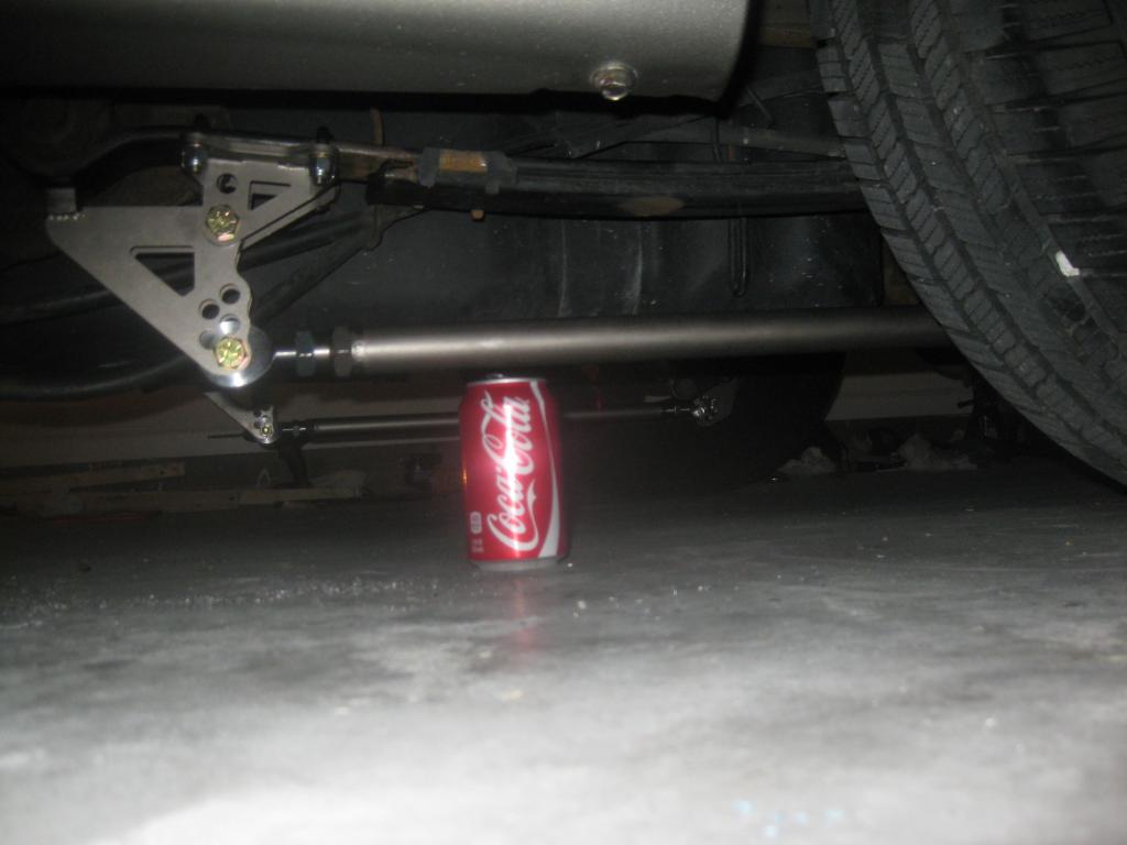

Well I finally got the traction bars done, but I haven't gotten to try them out yet. I do still have to clamp the front of the leaf springs back together but I'm not quite sure how I want to do that yet... Maybe I'll be able to get some tuning done tomorrow and hopefully hit the track on Friday.
Here you can see how much of the threads on the heim joint are exposed. I should've measured the length of threads before I buttoned the bars up because now Im not sure how much is threaded into the bars...I might have to order some longer heim joints.
Losing ground clearance, one mod at a time! I had to be careful on speed bumps before, but now I don't even think I want to try!
