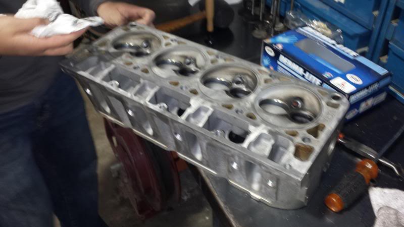

Long story short, I was at famoso running a few passes, and knew something was completely wrong. Had it towed home and friend pulled motor for me. Spun a bairing, torched rods, pistons, few cylinders were pitted, and was purely pissed. Maybe 5-6k miles on this motor and already gone. So anyways, I bought a few new products and ditched motor, mid mount turbo i use to have, and moving to front mount now.

My goals are to get in the 10's, and I believe I have a great chance to do it with this setup. My best old time was 11.7, and if this turbo doesn't workout for me, i'll sell it and buy a bigger one...
Everything is being done over. I pulled all the old pipe from the mid-mount turbo, tossed it all. I might use the Blow off, wastegate, and I/C piping. that's about it. Right now the truck is gutted, tranny was sold, T/C was sold, and replaced. Motor still needs a few things put together, maybe a few hours of work. Tranny needs built still, and fuel will still need to be installed. I'll be asking alot of questions, so i hope everyone doesn't mind if you get random messages..... I'm just researching peoples experiences, thanks for everyones help that I message, and actually responds.
I'll upload pictures later, thanks.

I just posted a few. Motor is in there, and parts are coming in day by day... Hopefully, I get it done right this time lol
