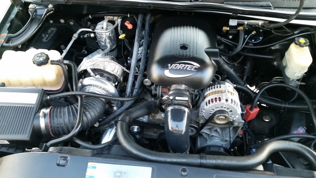

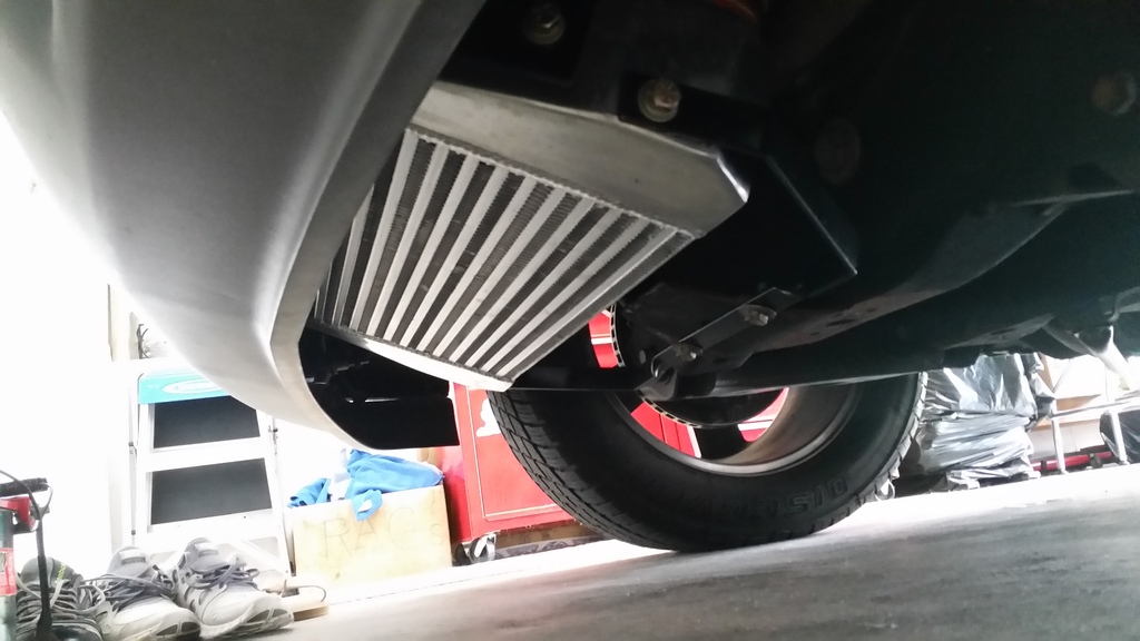

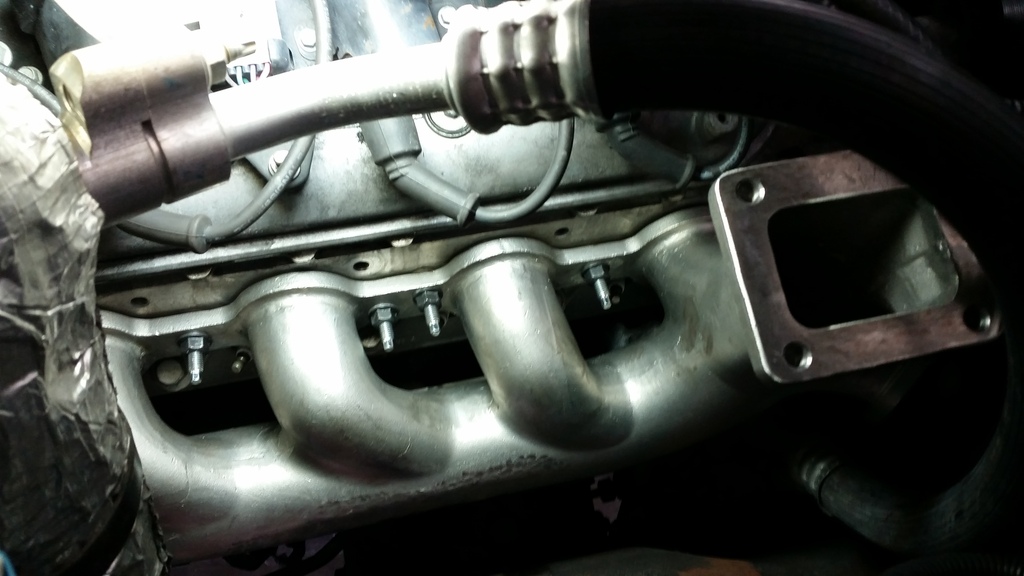

Here are some pics of my truck after getting the turbo installed (walk around video at the bottom)
Truck is a stock 5.3 auto w/ stock stall converter

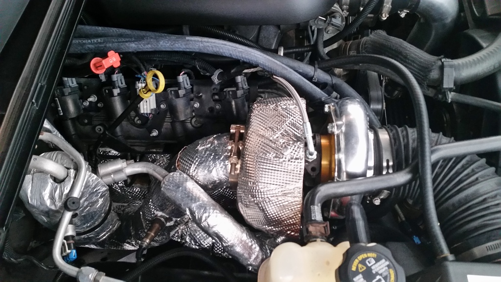

Trick hot side
Turbonetics 62-1

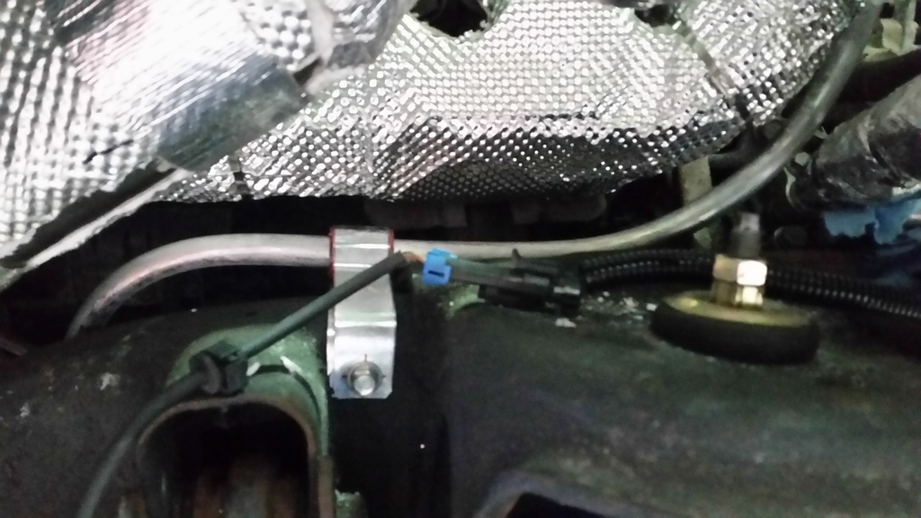

Oil Drain Tube - 5/8"

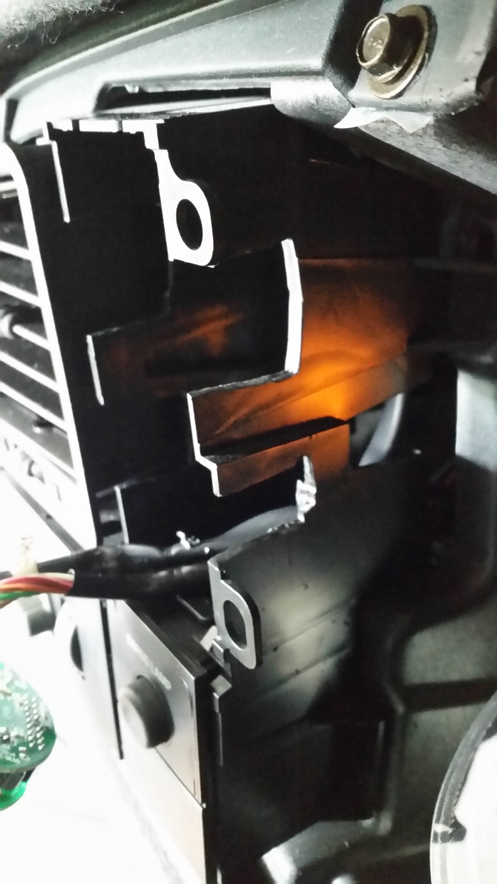

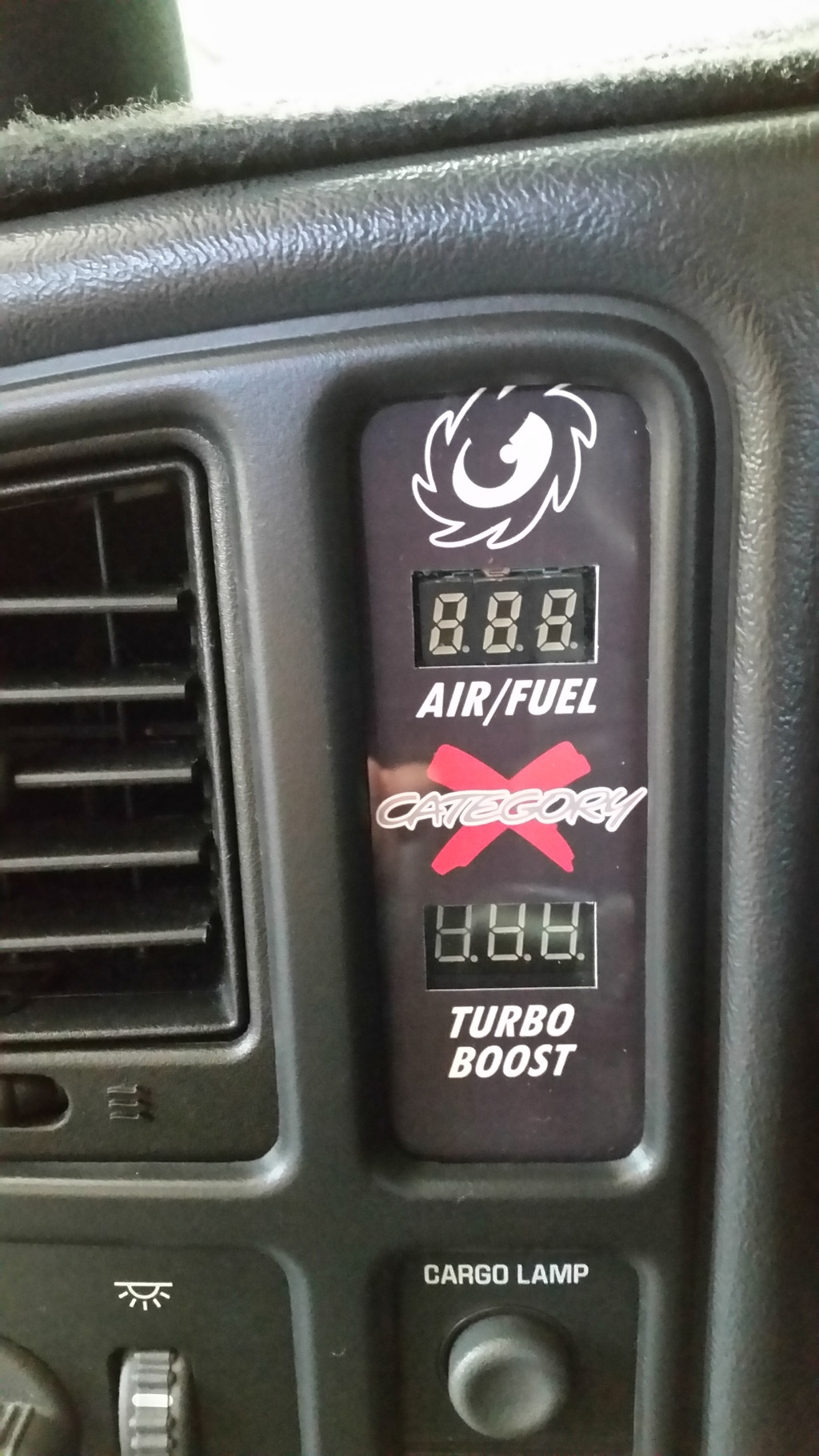

Here are some detailed pics of the custom boost & A/F dual gauges

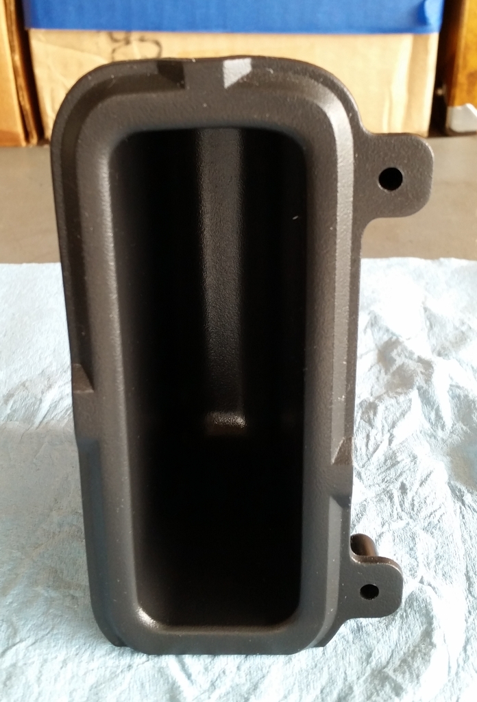

First, removed the useless pocket...

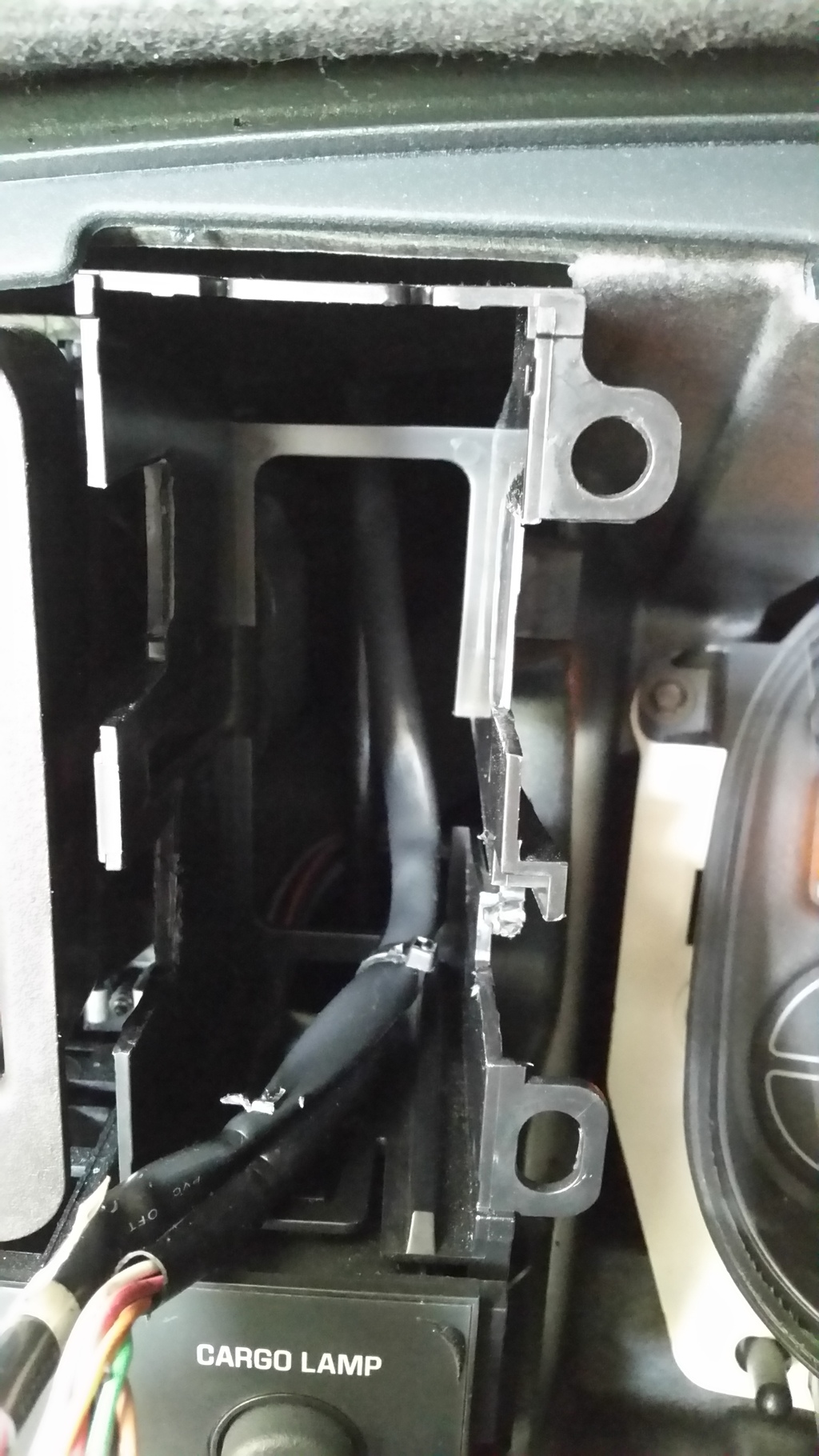

Then trimmed the dash a little to fit the gauges...

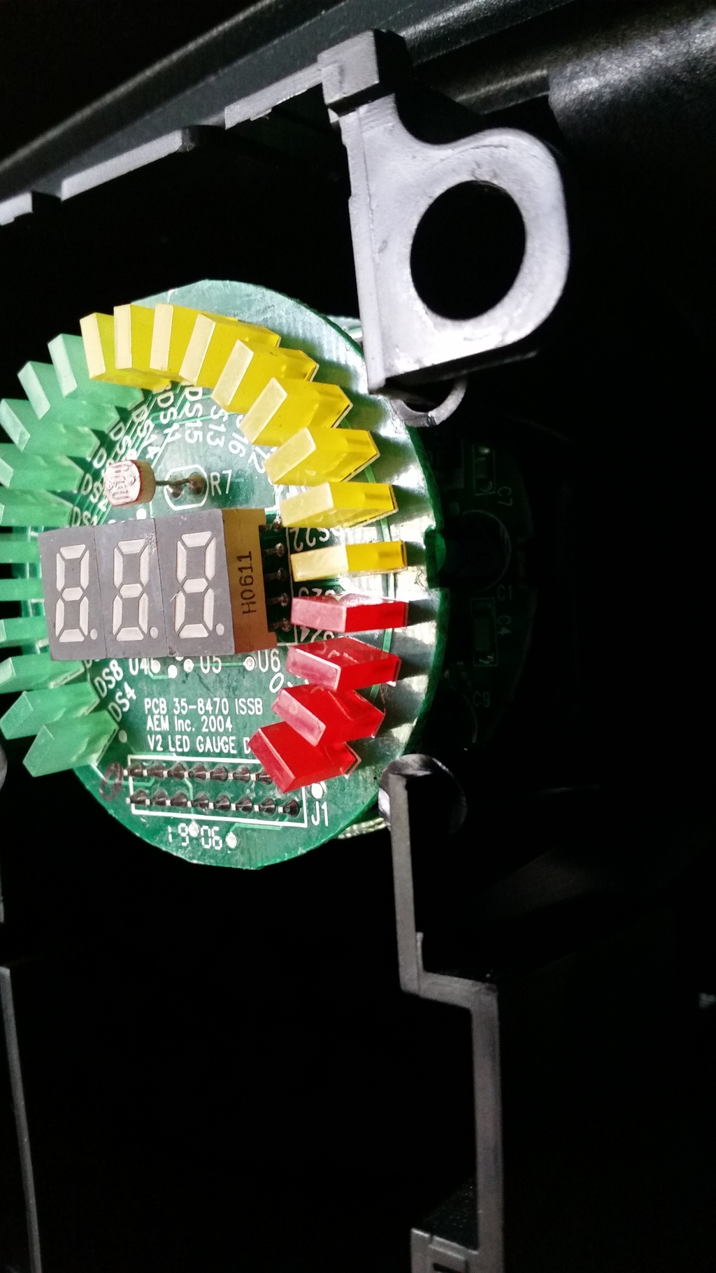

Fit the AEM wideband gauge...

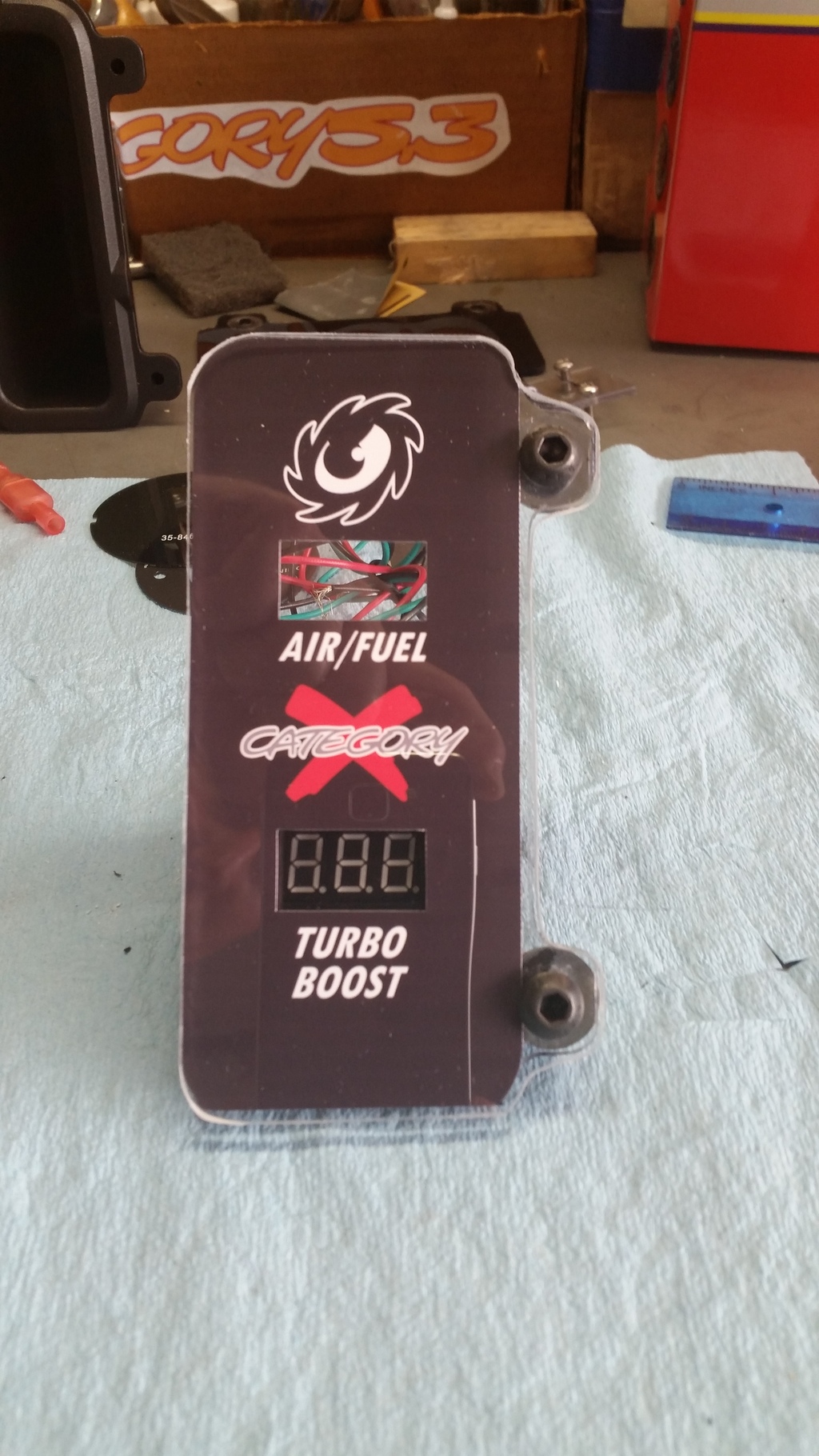

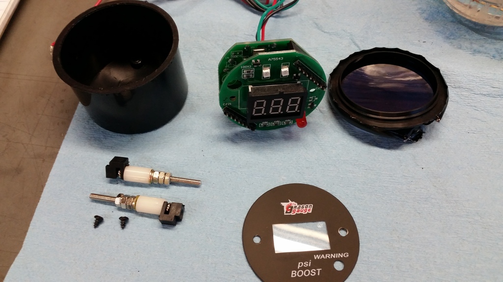

Disassembled a $20 china boost gauge....
Made a face plate...
Mounted the face plate in place of the old pocket...

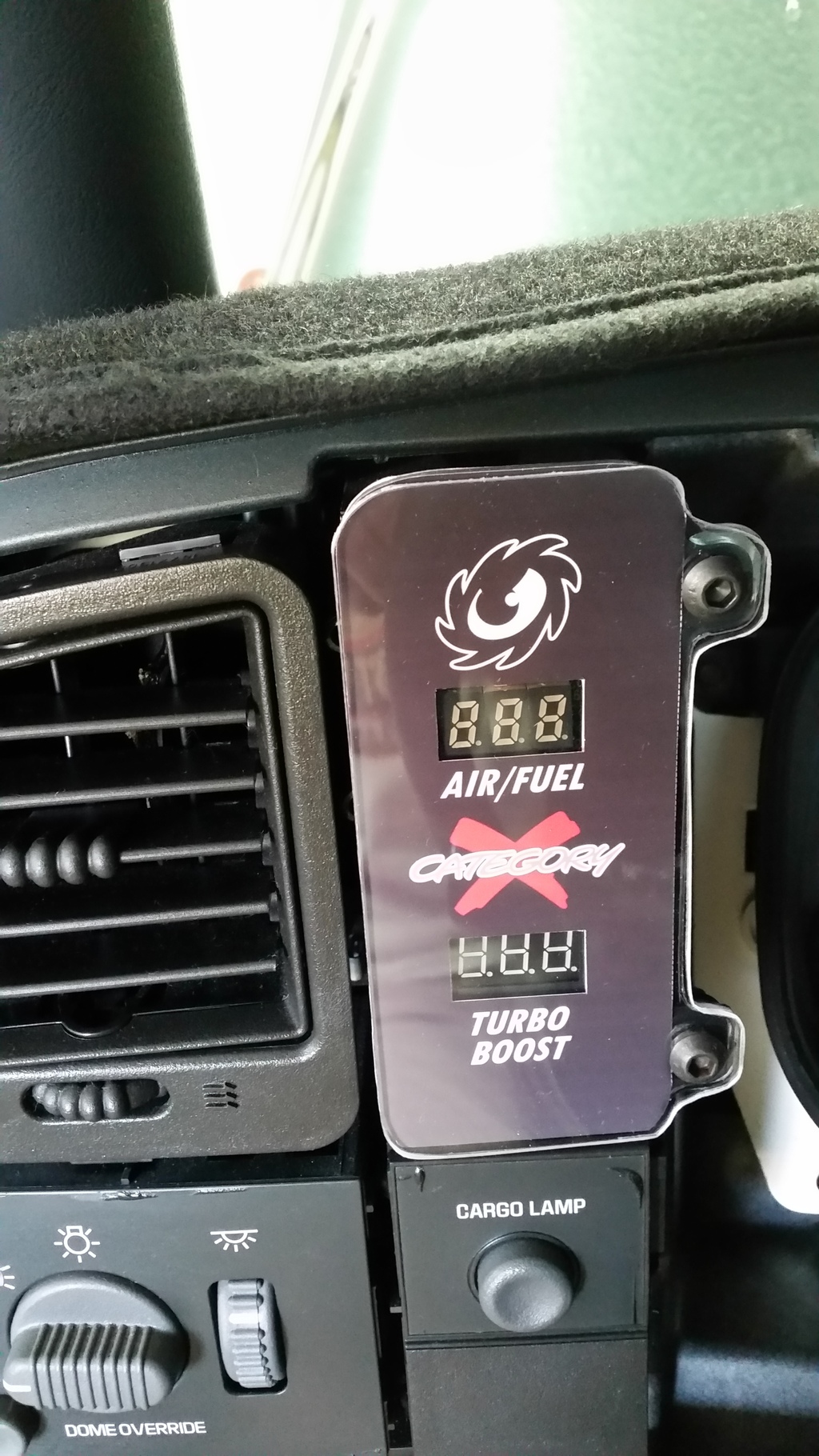

Finished Gauges in the dash....
