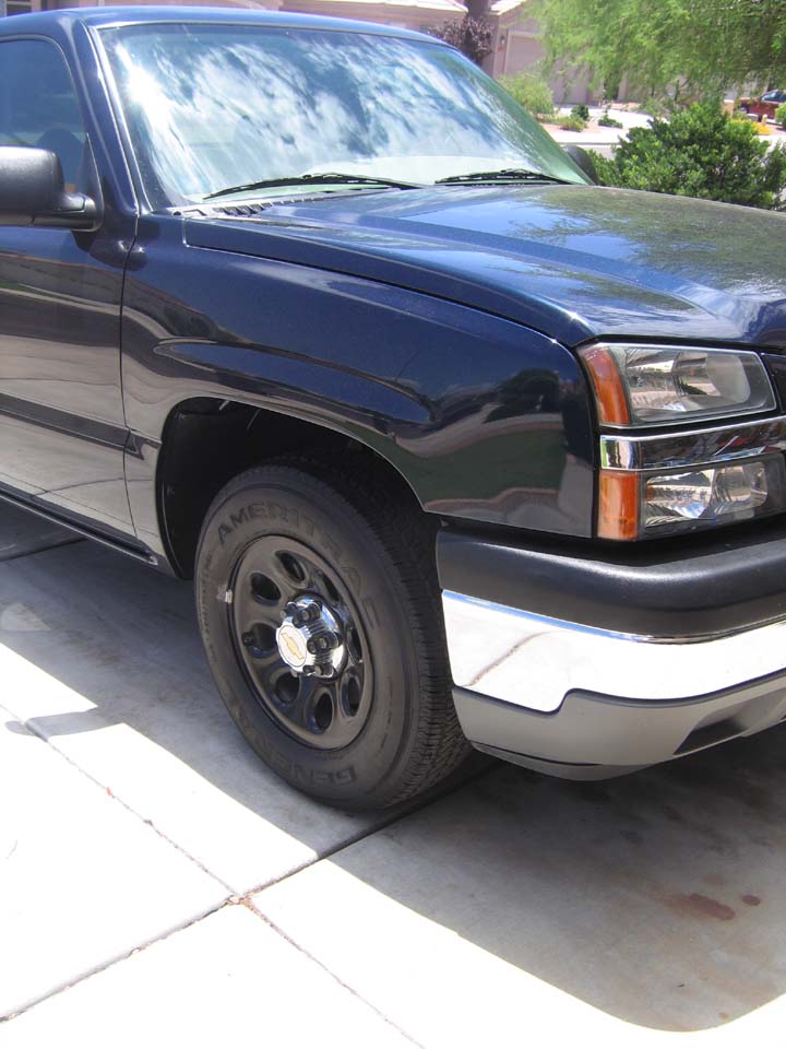

do you have any pics of the wheels? curious how the paint looks on he factory wheels. And bigger pics would be a plus lol
click on the pics and they get bigger..... i just spray painted them.. they turned out good but im gonna have them powdercoated.... back to the swap

95 bright teal's Avatar
Joined: Dec 2007
Posts: 2,862
From: Mesa, AZ
here you go 53bowtie
Good luck with the build!
should be a fun truck keep us updated
