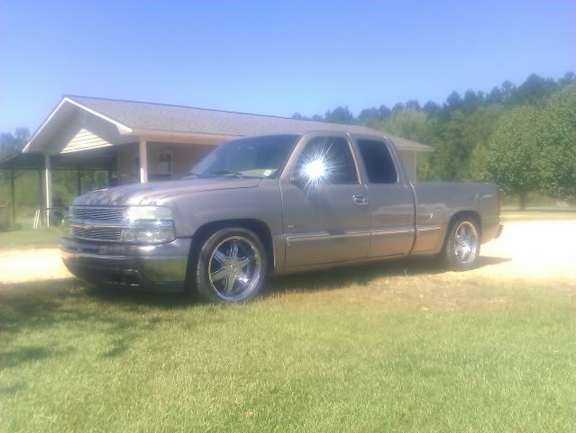

Started out with 5.3/60e 3.42s and peg leg. I have always modded the truck with simple crap and used to race all the trucks like mine around here alot and pretty much win all the time so that always led me to spending money on more stuff going faster. my first real mod was a tune from Geoff at EPS and shortly after cam a set of LPP long tubes. I think the best at that time was like a 14.9 and unknown mph. I was happy for a little while. Then i got a little more serious and wonted a converter so i got me a circle d 278mm with a shift kit and sonnax servos and around the same time me and a buddy swapped rear ends( he had4.10s/g80) and man i thought i was the king of the streets around here lol. I think around this time i was running somewhere around a 14.4-14.5 and it felt great for a heavy truck. But like always i wonted to step it up again so i ordered a Hsw wet nitrous kit. For some reason i was always scared of nitrous and never have sprayed more than 100 shot but that led me to run somewhere around 13.6-13.7 range.

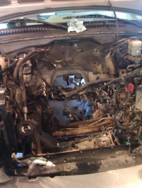

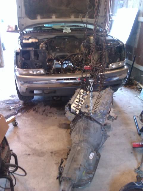

Out with the 5.3/60e and in with the 6.0/80e
21 Hours Later pretty much non stop other than eating breaks we had that sucker back together with a base tune so i could go home and sleep... lol

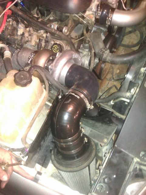

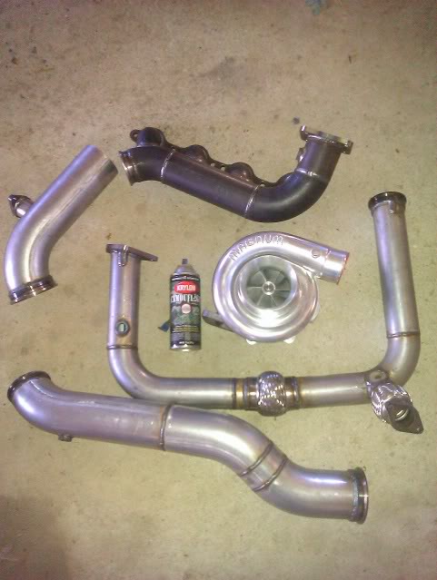

Started out with his standard hot parts with 3.5 " down pipe and a magnum t76 q trim turbo.

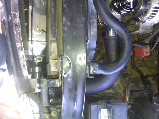

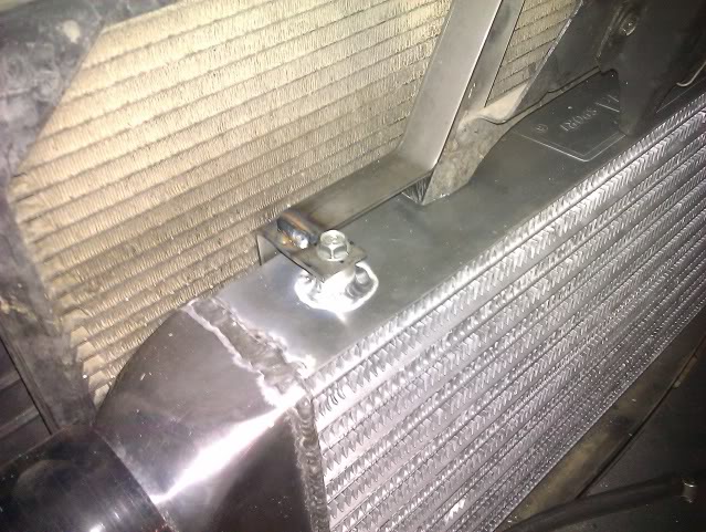

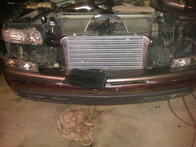

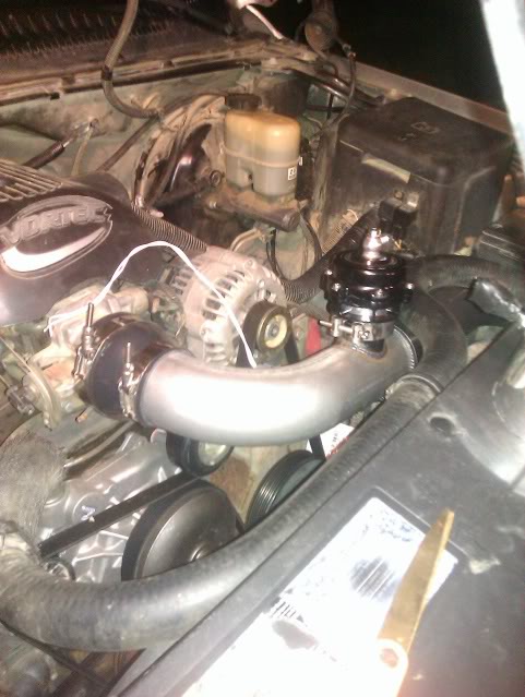

Couple weeks later i had enough parts to move on with the install so one night i started with the cold side to get that out of the way. Its a ebay intercooler and 3" universal piping kit and it was pretty decent i thought. i just ordered some extra 90 degree couplings for tight turns and stuff.
So i had all that done and i gave it a day or so and i started with the rest of the turbo install...

Wont bore you guys with too many of those kind of pics cuz we all know what a turbo kit looks like now days lol

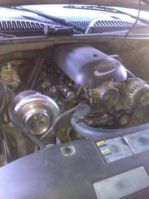

So soon after i had the exhaust welded up and drove up to nonnies again so he could do some tuning on it so i could finally make some boost.
we tuned on it slowly for prolly 4-5 hours on 6 psi and it was really happy with it. I was instantly addicted to the sound and performance of the turbo.

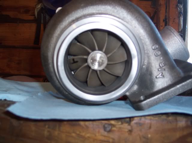

So for a few months i was happy and i think i managed a 12.80 or so on slicks and 10# of boost. After that i got the itch to spend some money on a converter and a new fancy turbo. I ended up getting a billet Circle D 3b 3400 and a precision pt 7675 cea. I had the turbo on for around a month before i put the converter and transgo hd2 shift kit in. The new turbo was alot better up top. I was impressed with the gains on my lq4.Nonnie did only ve changes pretty much to get the fueling in order and didnt really take advantage of the spark just yet. But then it was time to get the converter in and that got finished up on a friday and the next day we all made the trip to Lena to see what it would do.

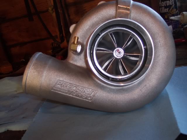

I have since bought efi live and a devils owns meth kit to keep my iats in check and iv been needing to tune my self for a while now and its been a great learning experience. I love tuning now and since i put the meth on and added several degrees timing in it feels like a whole new beast. I feel like i can now reach my 11 second goal easy in my heavy body.
The precision 7675

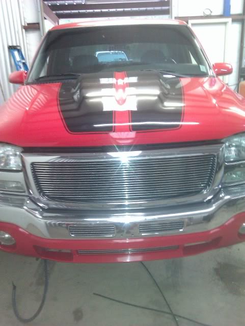

Now on to the most Current part of my build. I have the truck in a local body shop getting all the dents and dings pulled out and adding some good looks to it as well.
The truck is getting a new color(Victory red) along with a cowl hood, sport mirrors, paint matched everything pretty much, smooth tail gate cap, and it gonna have a set of silver stripes on the hood that will look just like this below (buddys truck). they follow the shape of the cowl hood and have pinstripes around them
Already been a coulple week without my baby and cant wait to see how it turns out. ill keep this thread updated and will post pics in the next week hopefully!

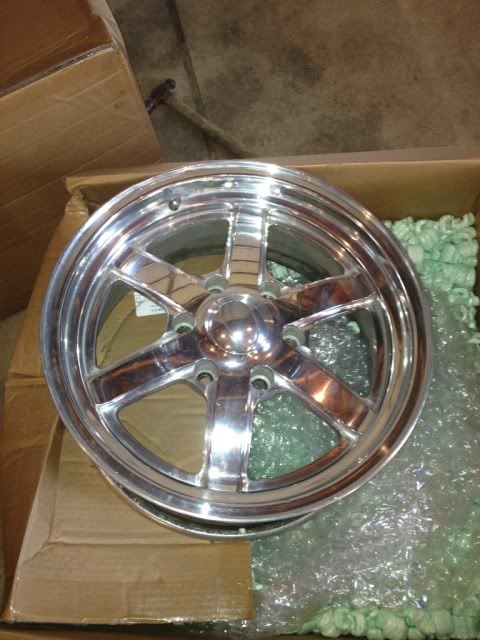

1. Boyd coddington 17x8 timeless 6 (Thanx Chevrolade!!!!)

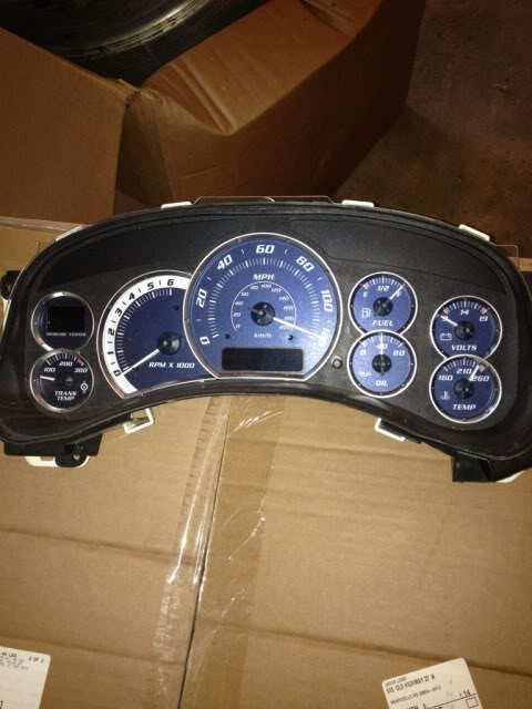

2. Got a nice esky cluster from another member on here. Cant remember who at the time... Been wonting one with a trans temp gauge and 120mph...

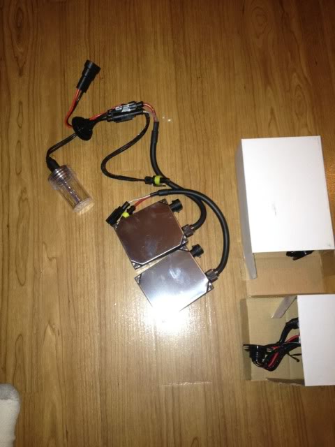

3. My ddm Hids came in today. 55w low beam 8000k and 55w high beam 6000k
