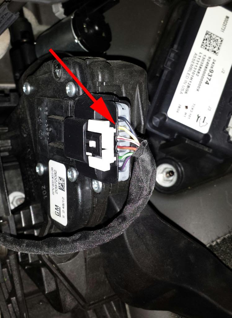

Ive looked all over the net trying to find this wire to hook up to my tps wot switch with no luck. Even the guys at NX couldnt help me with this problem. If anyone has any input it would be MUCH appreciated. Thanks

Sorry for the delay on the response but i figured I would post it in here anyway,
The TPS wire that you will need to tap into is actually at the throttle pedal.
You will need to tap into the yellow/white wire.

Oh nice. Thanks i already threw a microswitch on the pedal but i might look in to redoing it now. Thanks again
