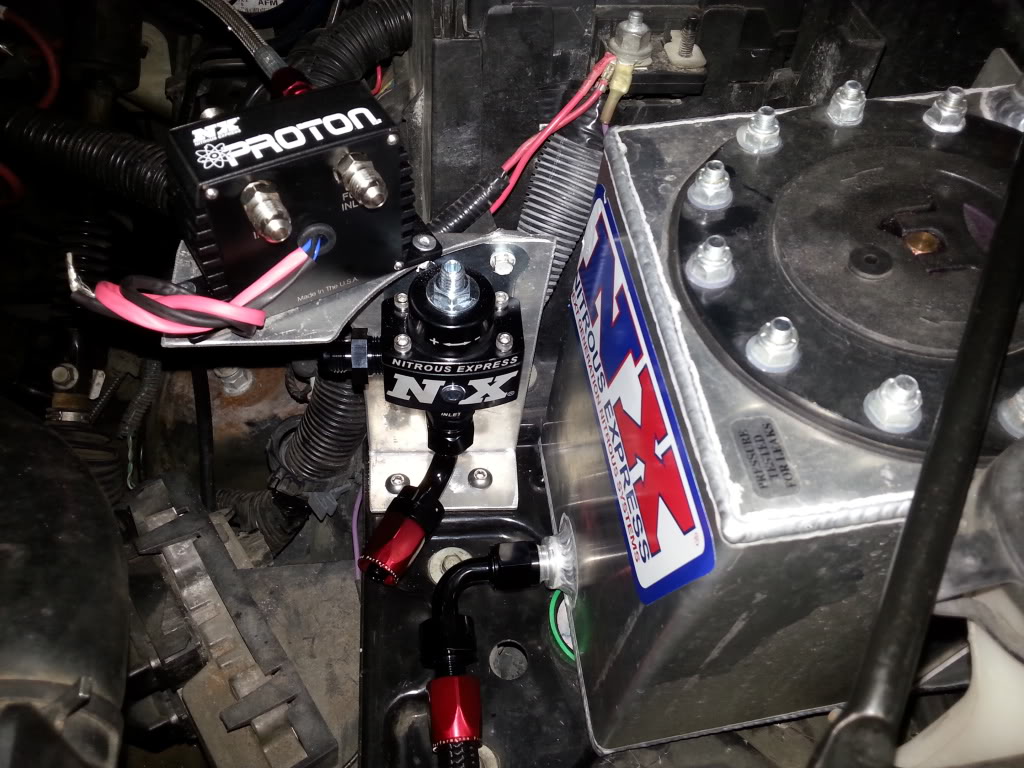

Gunna run race gas in cell and set up first stage to where I don't have to pull timing. The second stage will be on LNC-2000 retard for the 150-200shot depending on what first stage will do!

OP, is that a low pressure set up? What fuel pump?

Yes it's gunna be set at 10psi fuel pressure. My 408 has 11.2 comp ratio so boost is not happening in this DD
