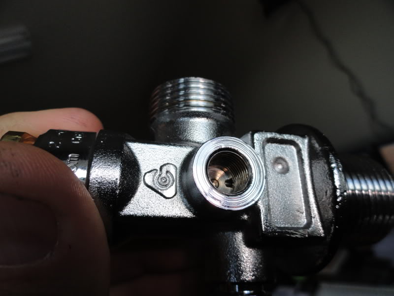

Well the standard $75 Hi-Flo valve from NOS will not work due to it not having the port which a pressure gauge screws into(which is the same port the compress air/NANO line feeds into).
Here is the DynoTune gauge port. Does anyone know if this is large enough to allow the compressed air to keep up with the exiting nitrous?

Old May 18, 2013 | 11:22 PM
L$X$10's Avatar
Joined: Nov 2008
Posts: 534
From: Guyton, GA
It works.
