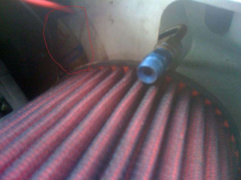

ill post pics tomorrow when theres light but its so simple, i have my solenoid in the fender then a 90 out of the solenoid thats in the end of the filter, so the nitrous will go across the maf for the extra fuel needed while spraying. all of this was done on a stock tune, i dont recommend it but i got all the way to a 175 dry shot while i was trying to blow my 5.3 up before the motor swap.

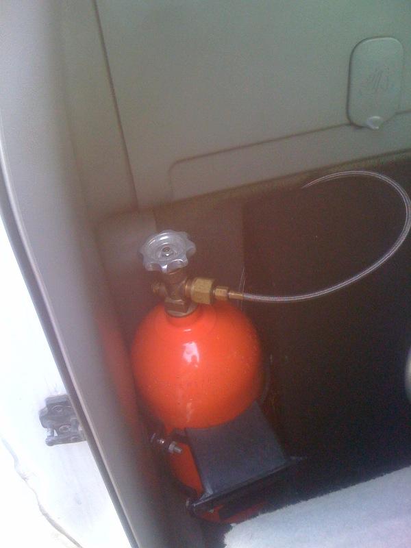

heres a couple pics of my setup. if u want a pic of a something just let me know and ill go take a pic and explain what its for and why its were it is.
and no the 5.3 did not blow up it held up to way more then i thought it could. but it is also a chevy
