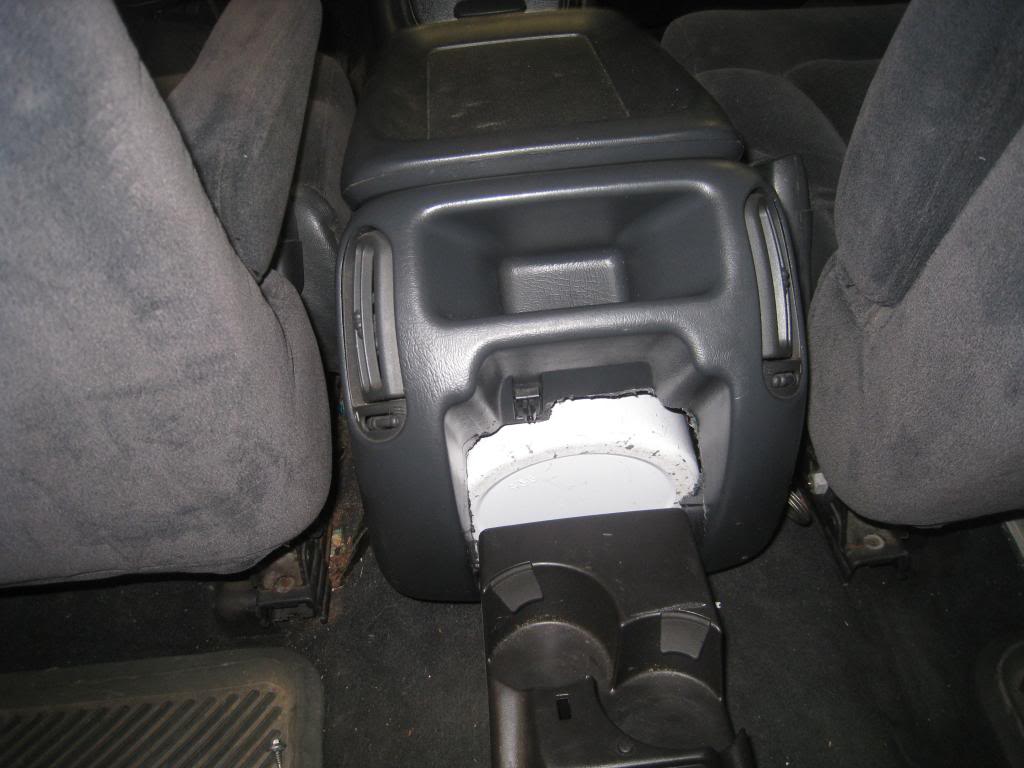

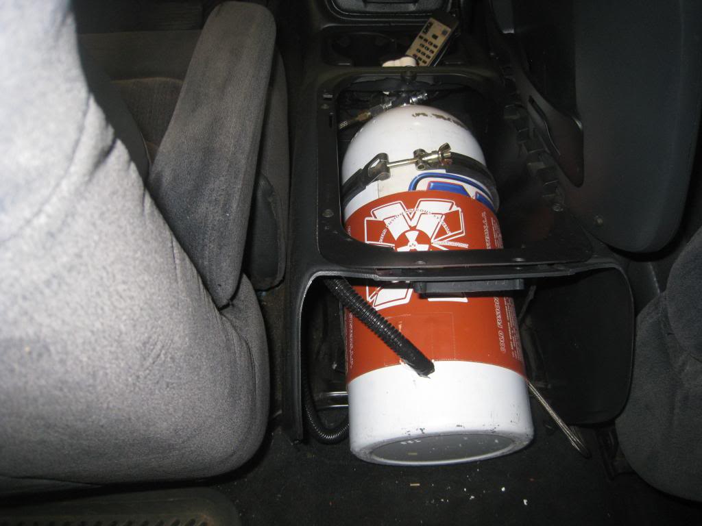

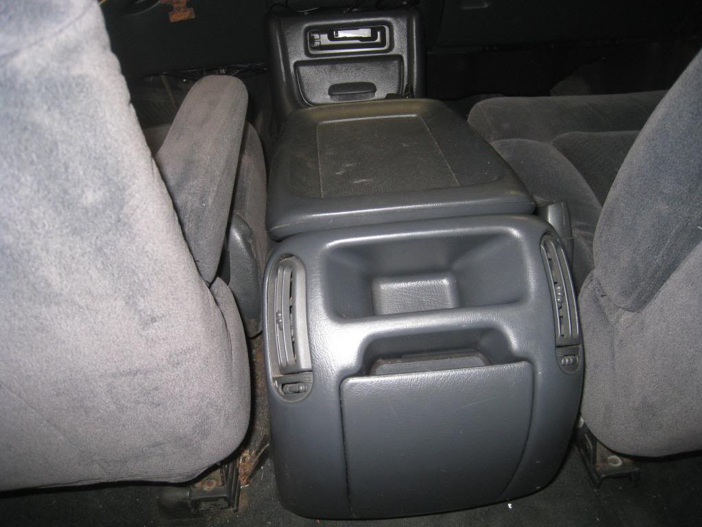

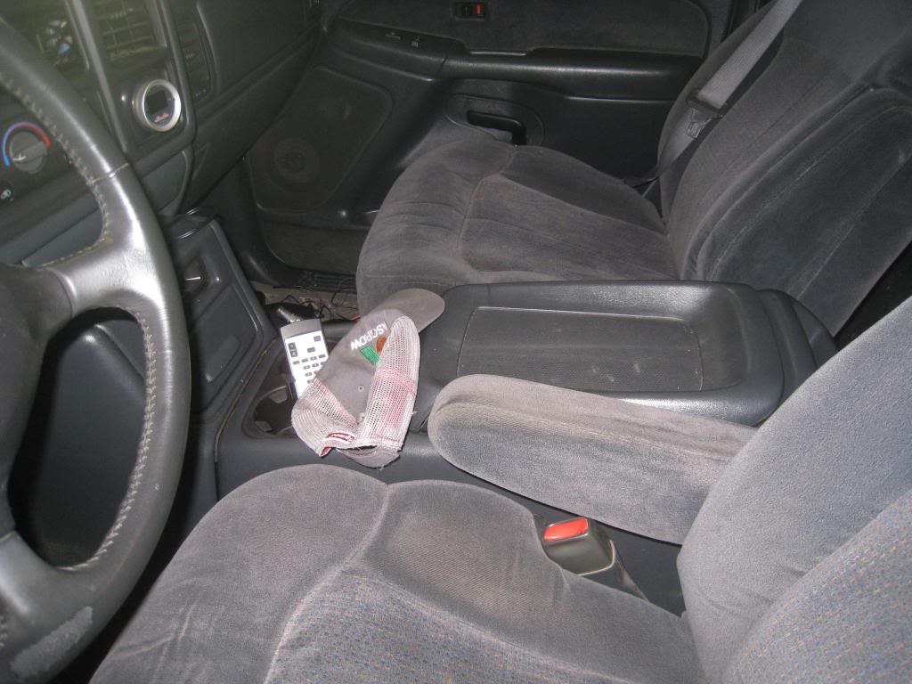

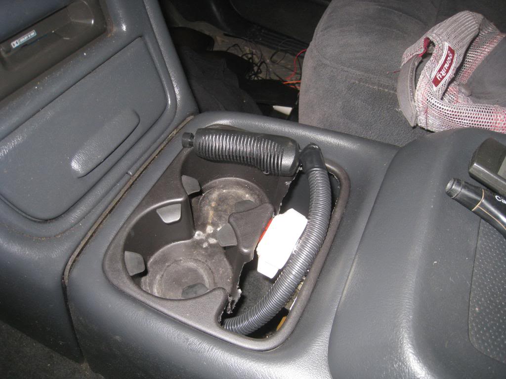

After thinking it over on having the bottle face the right way in order to allow the pickup tube to stay full during accel, I decided to rethink the bottle mount and ended up going this route. I have a spare cup holder that isn't modified that I will use when the bottle isn't in the truck. This way I can turn on the bottle without even having to open my console. It's full access from the driver seat without any strange movements.
Access to the bottle for removal and refilling is instant. The back section simply comes off with one tiny screw. Rear cupholders as well as front cupholders are still 100% usable. I really like this location and the way its mounted now.
Also mounted my switch panel.
