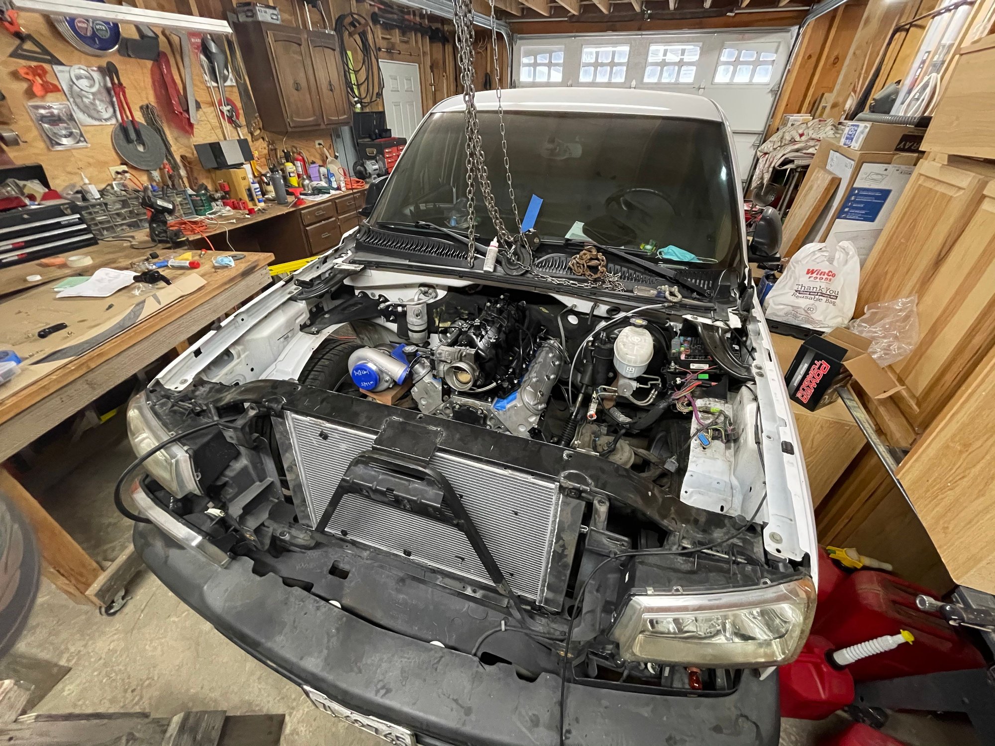

Originally Posted by arthursc2
Ive never measured torque required to spin a motor, but as long as it spins freely and you dont hear/feel anything grabbing/hitting I would wager you're ok
yeah, I was pretty paranoid about it. I bought a much thinner assembly lube and pulled it apart and put it alllll back together. Spins easier now. Still tight to start but I can make complete turns without any grabbing or dragging so I’m going to send it!

starting to wire and plumb everything up on the truck. I am pushing the fuse box back and under the fender support. Also, putting a low profile toolbox in the bed where the battery will go. Should make for a clean engine bay
