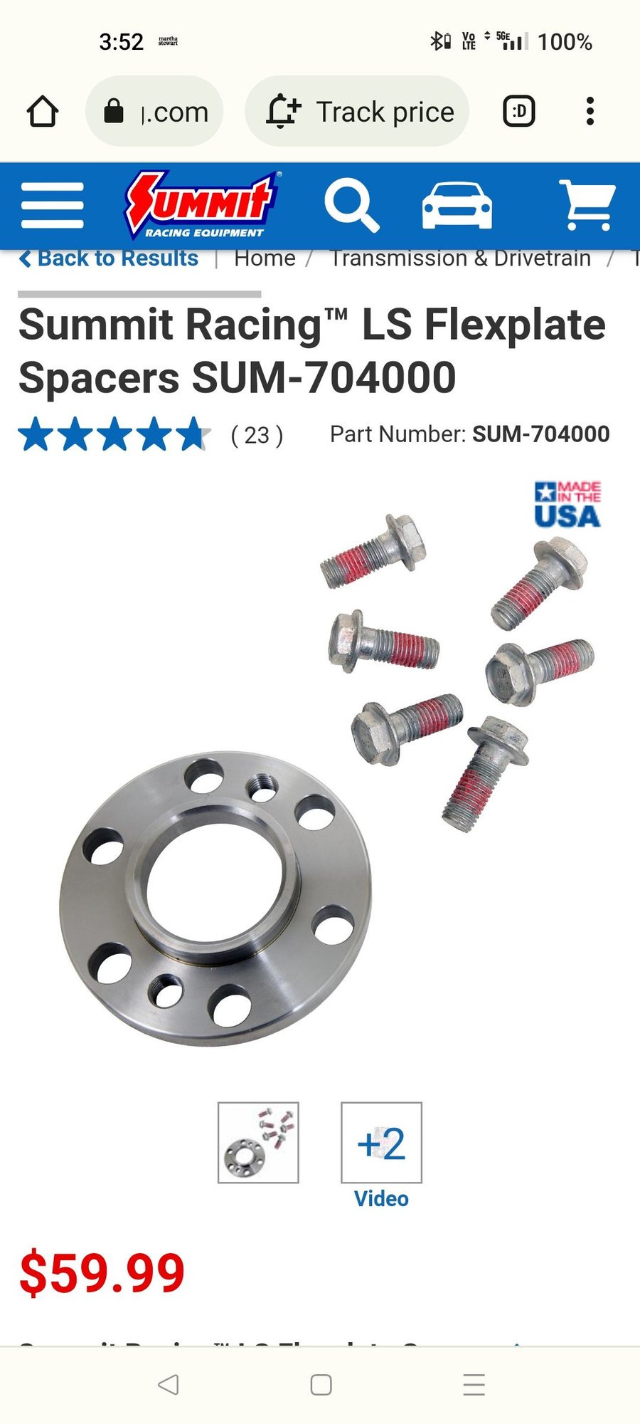

I meant a v6 4L60E sorry. This lq4 has a short crankshaft with a dished flexplate and I'm not sure if I need my spacer that I got for it or use the spacer and that dished flexplate?that's why I am confused because if I use the spacer it moves the flex plate further away and I don't think my 6.0 starter will work.
This is the spacer that I have for it.
Ok, gotcha. I actually have never bolted a 4L60e to an LQ4. The LQ4 came in the 2500+ trucks, so the flex plate that came with it has 6 holes and won't work for you.
Here's an article I always refer to when this question comes up:
https://ls1tech.com/forums/automatic...s-spacers.html
Maybe source a starter from an Escalade. Those had the nearly identical LQ9 and a 4L65, both are pretty much the same dimensionally to your setup.

Actually this come out of a 2003 GMC Yukon with a factory 4l65 all-wheel drive and is only three holes in the flex plate. I've been told since the V6 4l60 has a shorter input shaft I have to use a spacer but I'm not sure
The transmission input shafts are all the same (in this generation of trucks). The input shaft of a V6 4L60e and input shaft of a 6.0 4L65e are dimensionally the same.
According to that article I posted earlier, all you need is the dished flex plate with 11.066" bolt pattern. If I understand correctly, the dished flex plate and the LS style 4L60e 300 mm input shaft/torque converter (which you have) basically locates the starter in the "normal" position.
