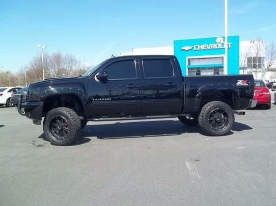

I’m new here. New to the performance scene and to this forum. Don’t know if I’m posting right. I have a 2013 Chevy Silverado 4wd and I had a mechanic put in a stage 4 Texas speed cam and valve springs and rods and lifters and had a dod and vvt delete. I drove it about 3 months tryin to tune it and all of a sudden I have a knock. Mechanic said it could be spun bearings or broken rod. Did I put too big of a cam in it? What could have caused this? What are my options? Rebuild or get a short block motor to put in it. I’m already 6k in the hole on this build.
