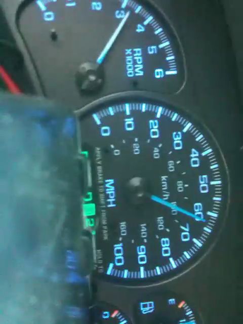

New trans and converter finally in and working well. Chris @ Circle D did a great job on the converter. Nice and tight around town but works very well up top. Shift extensions are awesome, about 550 rpm on the 2-3 shift and yet the converter couples extremely well.
Drop to 2nd
(sorry about the tilt)
All 3rd gear

holy crap! how much boost?

13.5 psi peaking at 14 psi, 14* on E50. Should be right in the sweet spot of this turbo. I believe stock48 said his 475 was done around 16-17 psi on his 6.0

What fuel pump?

Single walbro 450. Already maxed out on E85 @ 12 psi. Trying E50 to get more out of it, seems done at the current level. Absolutely great fuel pump. Factory drop in and actually quieter than my stock one. I will add another and max out this turbo.
