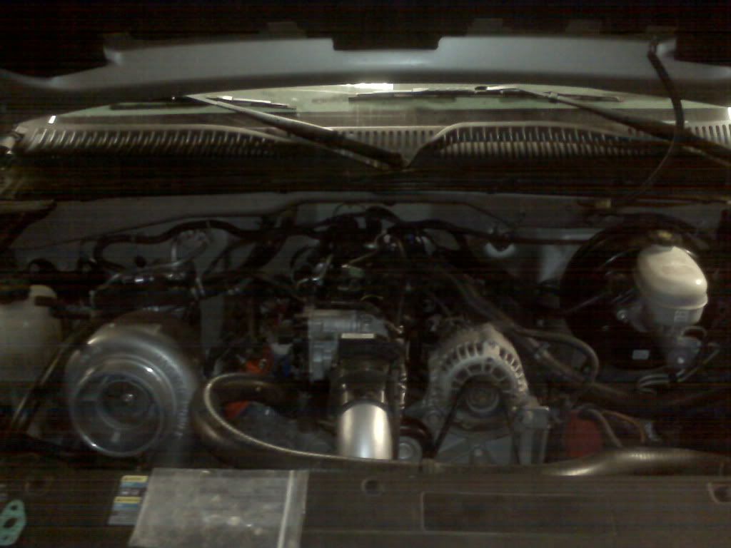

Specs
4.8, LS6 cam and springs, KBR Front mount, Master Power GT-42 64mm 7lbs, cobra "pencil" injectors and a single walbro 255 with a weak *** tune.
4L80e with great internal parts, but it has no 4th and shutters in 3rd and 3nd gear decel feels like i lost a tire everytime....i can go on.
4.11's and a tru-trac.
Did a center console "conversion" which i really recommend for all RCSB
If i can find a better camera i will take some better day shots at the water bridge.

10 psi, 11.1 afr, 16* commanded, about 65-70* outside temp.

Me too. Still need to get a fully functioning 80e but i have found its weakspots and can drive around them.
