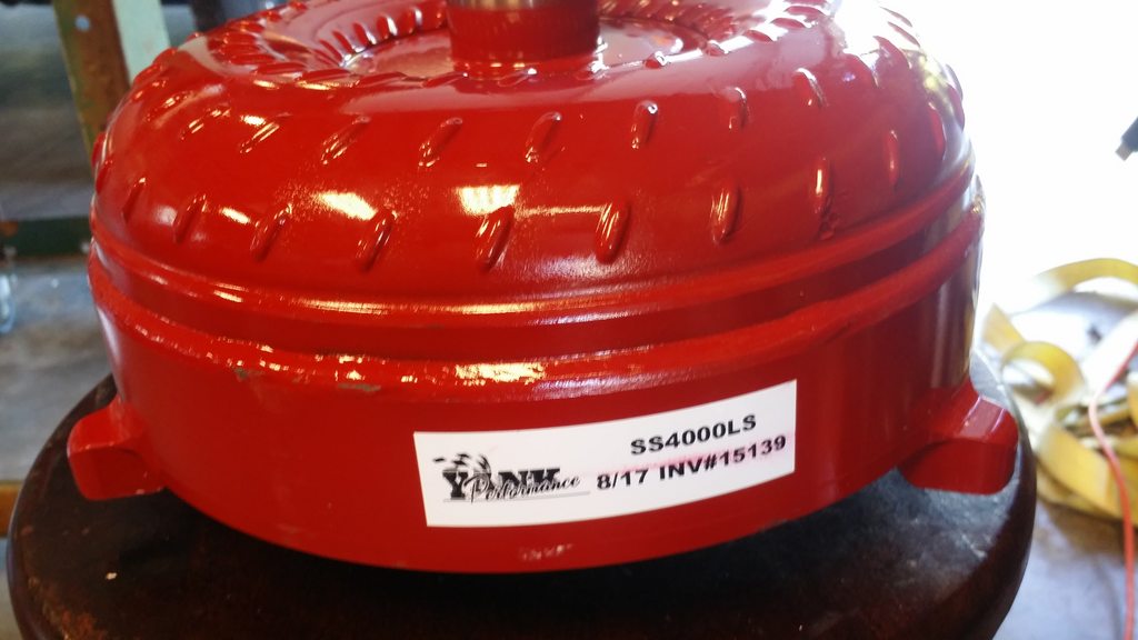

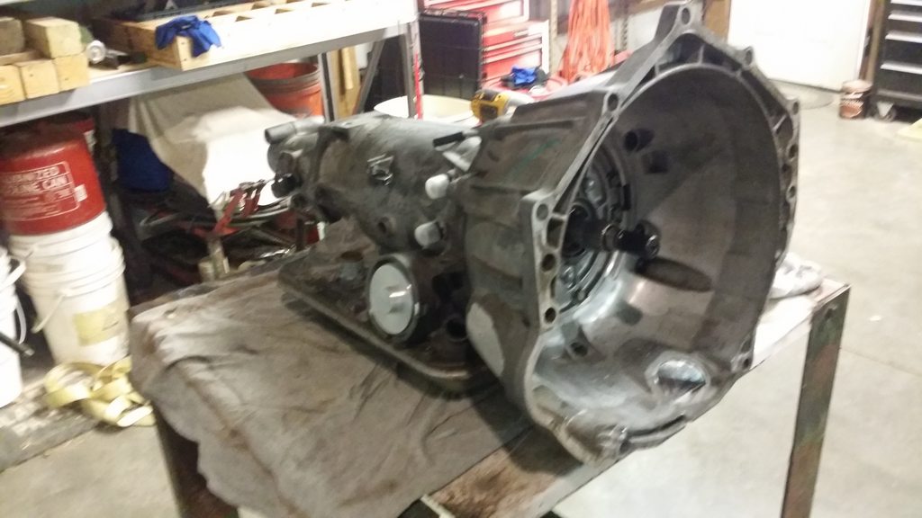

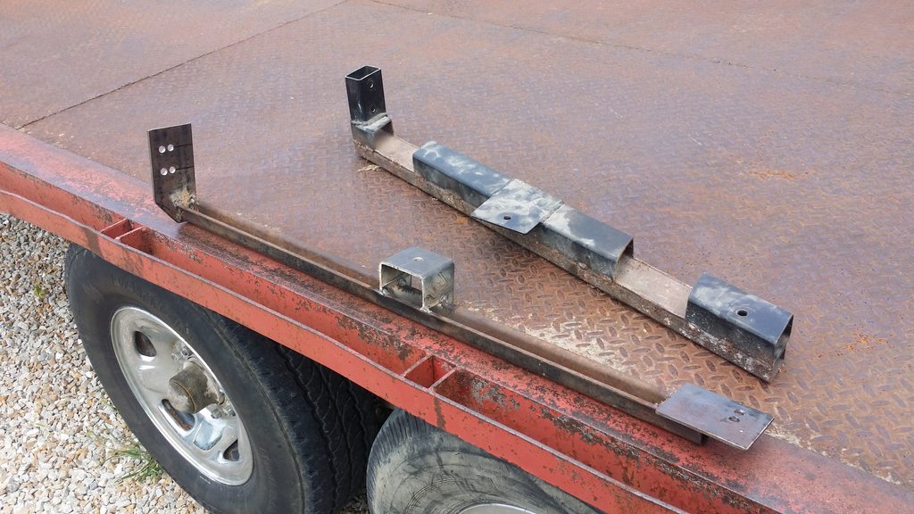

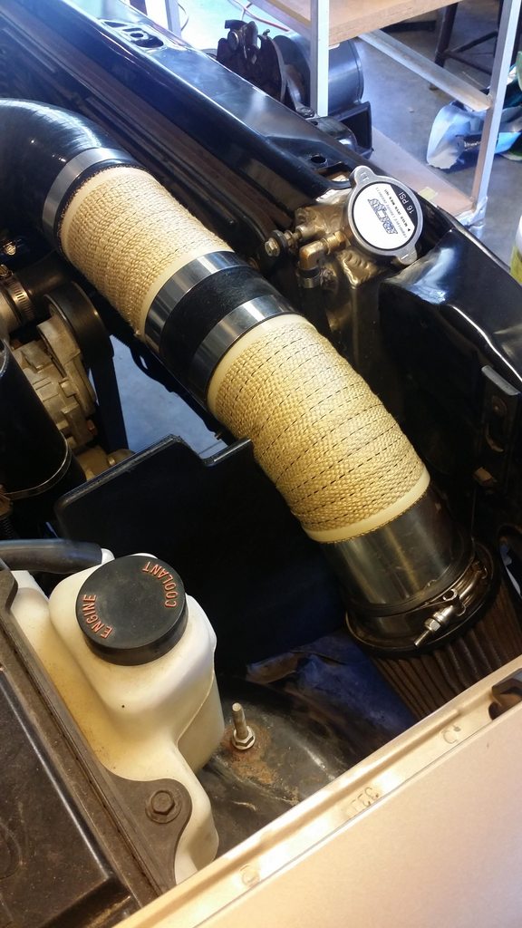

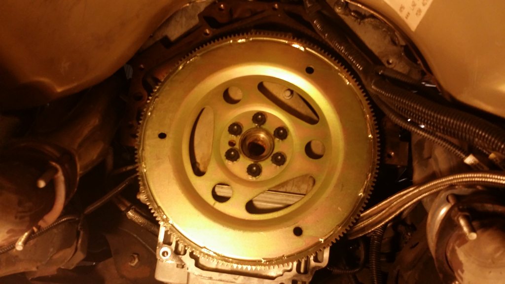

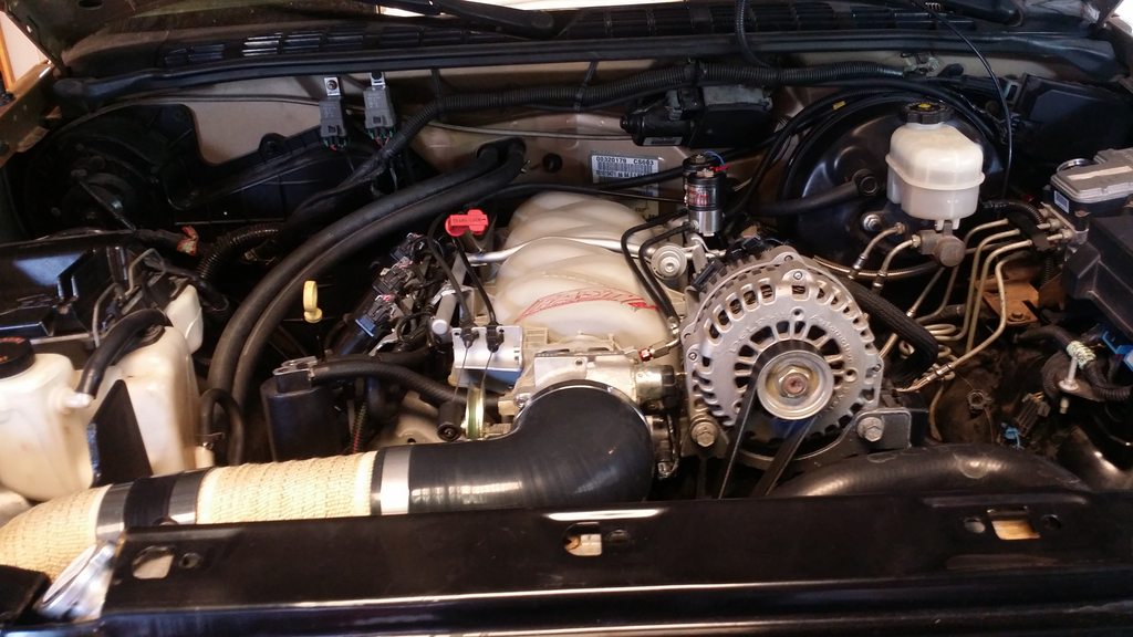

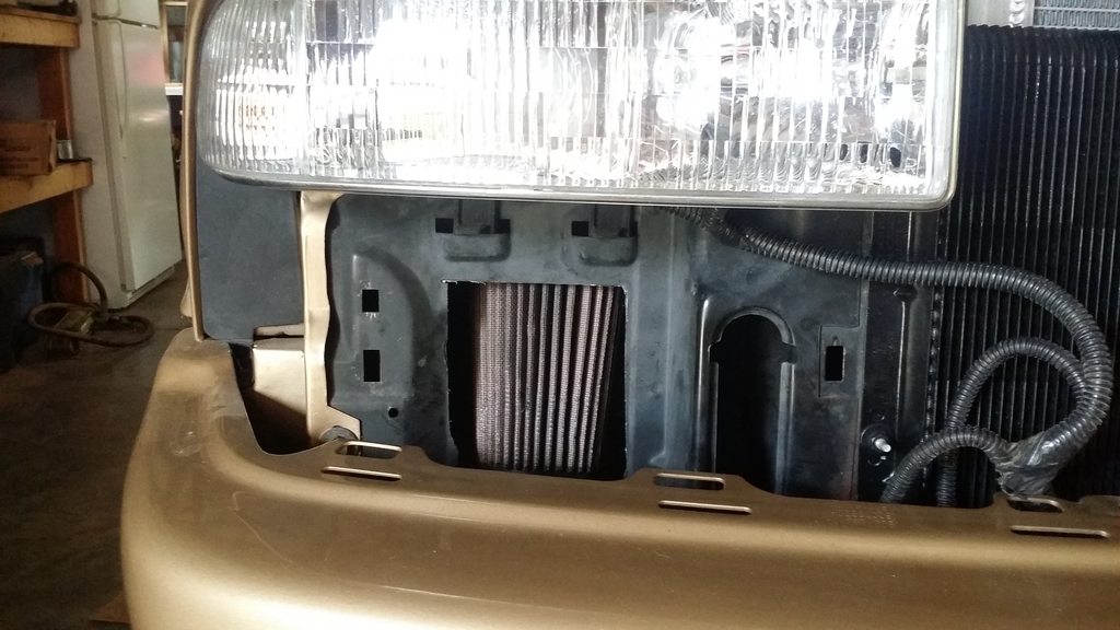

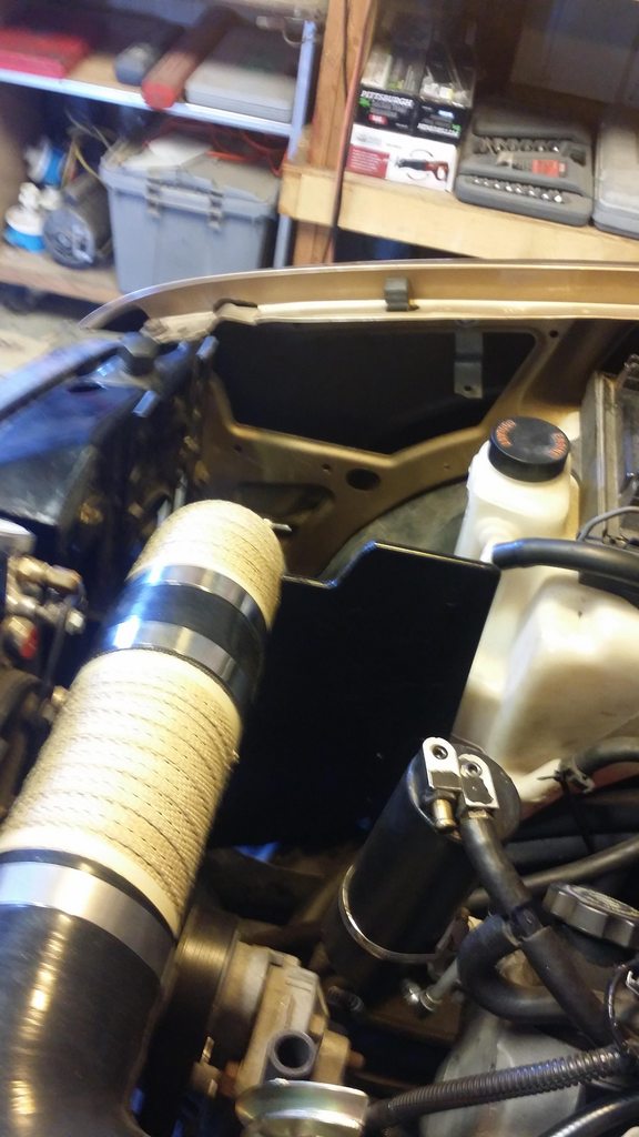

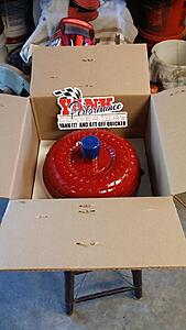

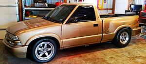

2 Years ago I took my truck to the track after I got it together and running on a conservative tune. It made 4 passes, each pass getting faster, but I could only run the best of 12.99 @106 with a sad 1.91 60'. After I got the truck home it sat for about 2 weeks and I decided to drive it to my wife's prenatal appointment for my youngest son. I got on the highway and it shifted 1,2,3 but then nothing. It would shift into OD but it was like it was in neutral. I limped it home and parked it. It sat for 2 years until last month with only being started twice and the battery charged once. I have now decided I am tired of it sitting around and not being used. I bought a 650HP rebuild kit for my 4L60E and also an upgraded input shaft with the suntrax upgraded drum. It should hold more HP than I will throw at it for a long time. I also felt the converter was too tight for my setup. I got with yank and we decided on an ss4000 for the truck and since I was upgrading I decided to install an SFI rated flexplate in place of the stocker. I have also upgraded a few small things like the air intake, trans cross-member, some fittings and some other random things. I also picked up some 26" tall drag radials to run in place of my 28" tall drag radials.
I have a race locked in with a good buddy in his 406sbc camaro. He has been 12.3 @110 with a 1.80 60'
The challengers car...
I got it back together and just got the break in miles on the converter. I will be updating this as time goes on.
Here is a pic of the truck and some of the parts.

Some nitrous would have loosened that converter up. Probably cheaper too!

Thanks! I'm looking forward to getting this truck on some DR's, Street tires aren't cutting it right now. lol
It will prob still get a little shot down the road.
