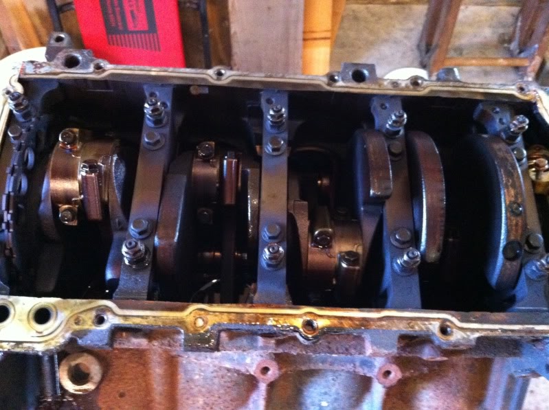

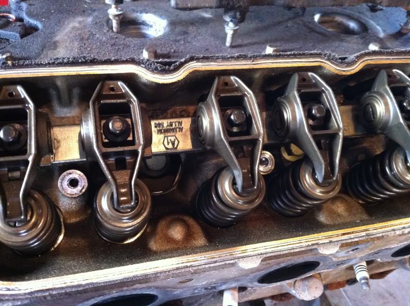

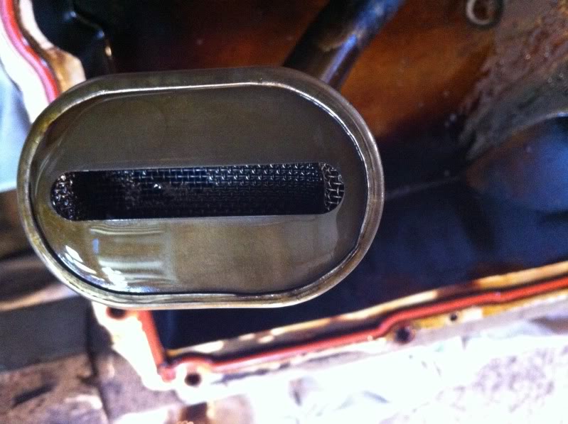

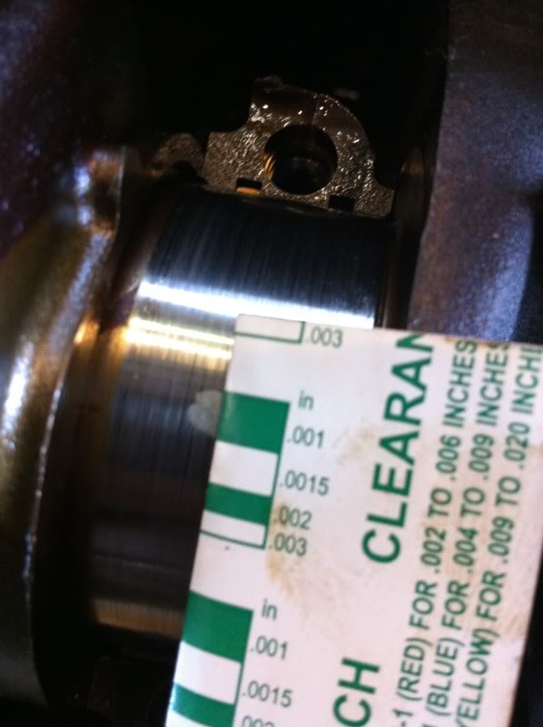

I had just a little bit of time today and decided to open up the 6.0 I bought. The guy I bought it from said it "lost oil pressure". I'm guessing after checking this thing out that it was the sender only.

Swapped the pushrods for 7.300's and the lifter is louder now. Way louder, even though I have the correct preload on the lifter. At this point I need to pull the head to find out what is really going on. It may be turned in the cup or not pumping up (not likely since I can measure preload) or it might be something else. The only way to pull the heads on my S10 is to pull the motor. SOOOOOOOO It looks like this pile may never run. But if I or when I pull the motor I will be going back in with the 6.0.

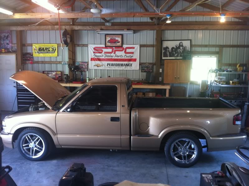

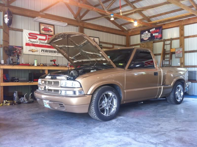

If I can't figure out this lifter issue, the motor is coming out and all my hard work will be for nothing. I'm a little deflated right now. lol I did take a pic of her together in her resting spot till the operation is over.
