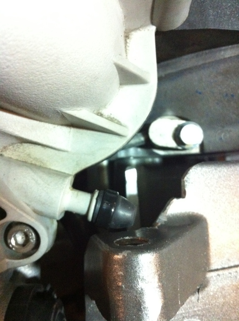

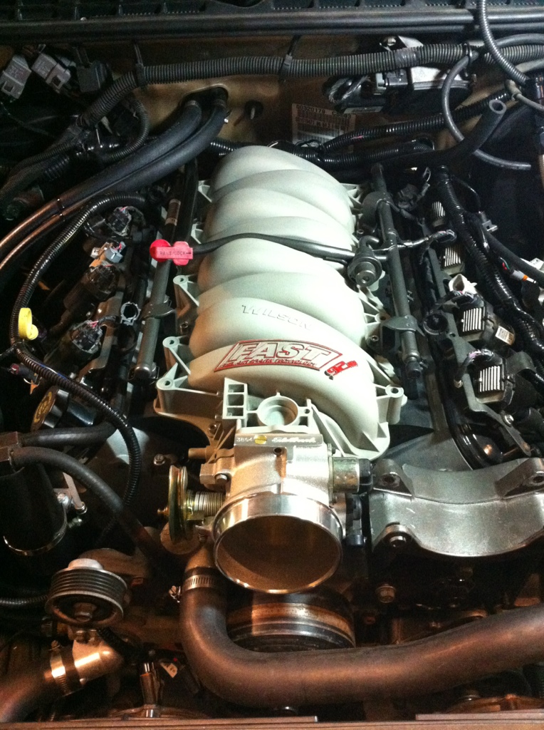

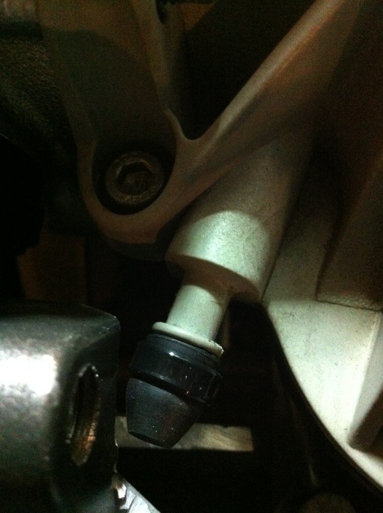

I went to swap intakes the other day and ran in to some issues. First off the evap nipple was in a different position so it hit the truck acc bracket, second the 90mm TB I am running doesn't have a vacuum port on it like the stocker so the catch can setup didn't work, third the LS1 steam tubes will not work with the FAST intake, fourth the port in the waterpump that the steam tube hooks to hit the TB cam. I think I have all the issues addressed and the intake is "on". Just a mock up but it is on. lol Here are a few pics of it and some of the stuff I did to get it to fit.
