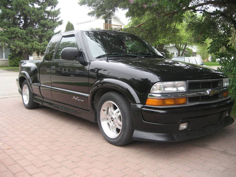

The truck I began with is an '03 xtreme extended cab with a 4.3 V6 auto. Heres a shot of it when I bought it a few years back:
Thats the photo that was used in the ad. Fast forward a few years and a couple thousand dollars, and this is where my project truck is at.

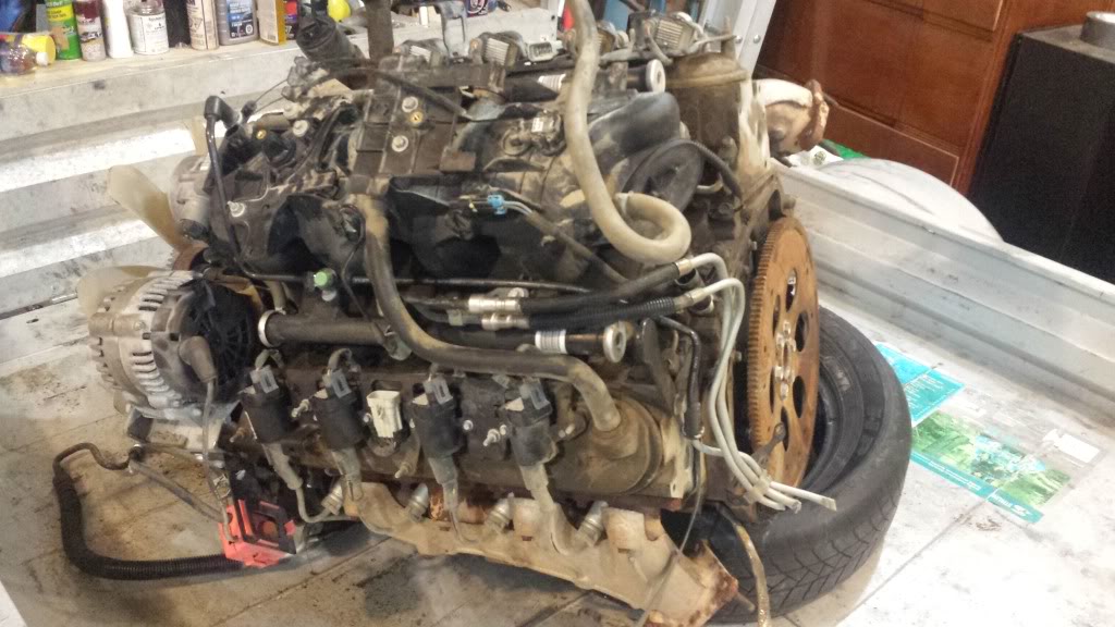

As far as the motorswap goes, I picked up an engine on saturday from a somewhat local junkyard.
I have yet to identify it as a 5.3 or 4.8. Regardless of what it is, I'm not to concerned. Right now I'm focused on getting it into the truck and then I'll worry about gains later.

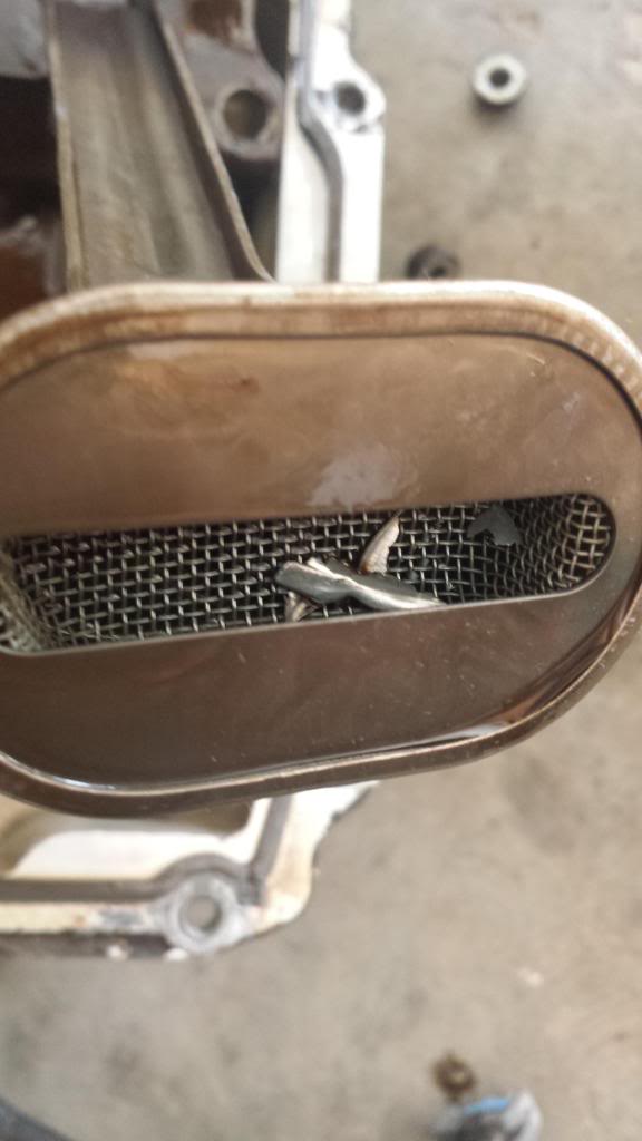

So I'm unsure of what to make of this. I found a few metal shavings/pieces after pulling the pan.
Heres the pickup tube:

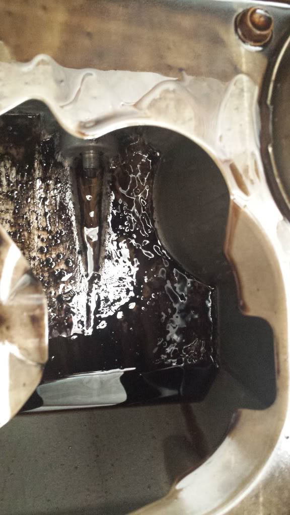

And the pan, not sure how well this photo is going to turn out:
Searching the forums a bit here, sometimes small pieces are common, and to be expected. Im concerned though that these pieces are a bit larger than average and a sign of a needed rebuild. Honestly, this is my first go at building an engine and am not 100% sure of what is appropriate in this situation. I've gathered all my knowledge from heavy researching.
Anyone have any go forward suggestions? Does this call for further tear down, or should it be fine as is? These few pieces in the pickup tube were the only larger sized pieces of metal I found.

It looks like there is something that needs attention in that motor. I would pull it down to the block and check it out. Wit the size of those metal shavings I would think that it would stand out like a sore thumb. It looks like rod barring material to me, but I'm not 100%. Did the junkyard say anything about it having rod knock?

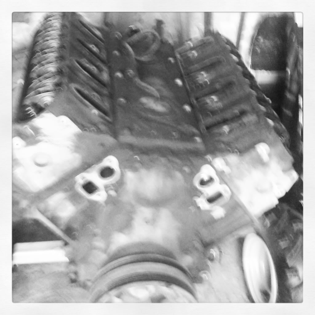

Haha honestly I havent been able to do much to it the last few days. Ill take some pics next time I get out there though for yall. Ill post one up in a minute or two of where im at
Old 07-28-2013, 11:07 AM
Lutz's Avatar
Join Date: Jul 2013
Posts: 12
Received 0 Likes on 0 Posts
Hope that works. Damn do I hate using photobucket on my phone. Such a crappy mobile app!
