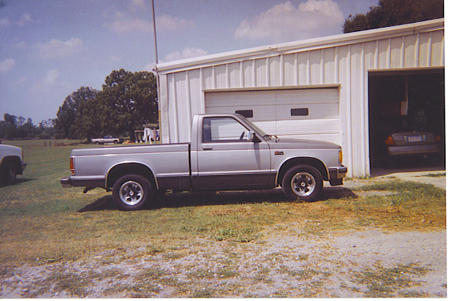

Here's a few pics of the truck over the last few years.
This was in'06 when it was painted.

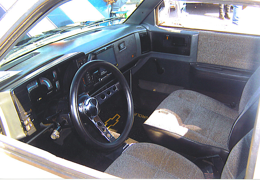

Before and after pics of newly reupholstered interior. Also sold the Jenson dvd/cd and put in a JVC cd player.
These are gonna look great when I get all my construction done.
