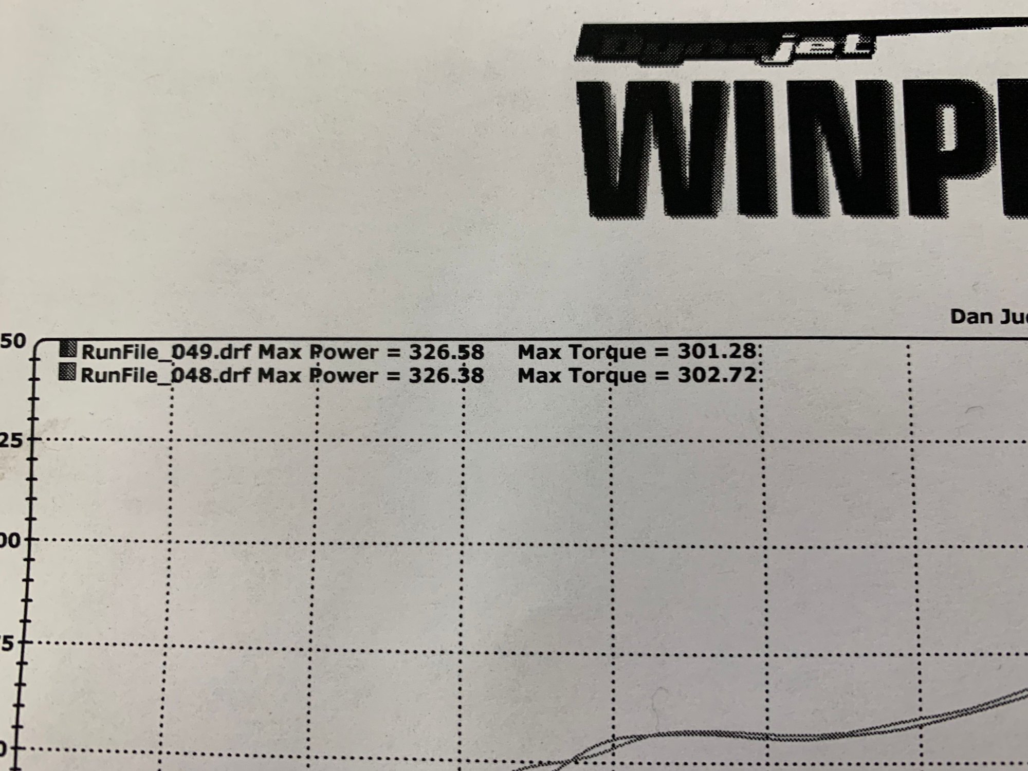

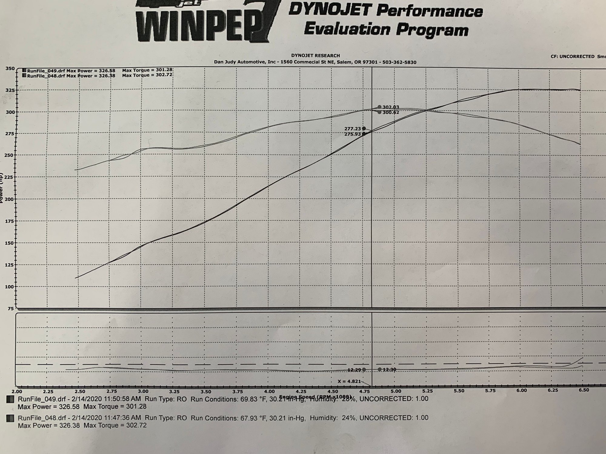

Got to throw the truck on the dyno jet I regularly tune on today. Happy with the power it made. Kept the rev limiter at 6500 to keep it safe, power looked to taper off right after 6500. This dyno reads a decent amount lower then the dyno jet at English racing. I’ve had a turbo Honda I tunes that made 467whp/303 torque on their dyno and it made 533/337 torque. First pull truck made 318/292 and was pretty lean. Got it right about 12.6-12.8 and that’s where it made best power.

I think that's pretty respectable for a 4.8 with just a cam and bolt ons.

I’m happy with the numbers. The truck feels great, it’s just about 10lbs per hp to the tire so it’s plenty of fun. I might keep my eyes open for a 6.0l if I can find one for a deal but for now I’m plenty happy with the little motor.

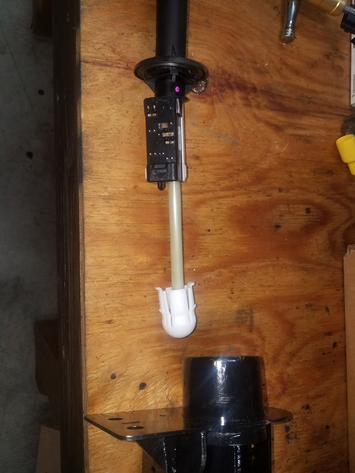

Alright help me out here please. I have a new master and atomics pedal bracket ready to install when one of mine dies on either truck. However I want to do the extension trick really badly. So where exactly does the cut piece of rod go between? Feel free to paint an arrow on the provided pics lol

Does that rod pull out of the master? My s10 master rod pushy guy came right out and I inserted 👉👌 the space between the pushrod and master cylinder hole where that went.

Ok I gotcha that's why I was a little confused I didn't tug on the rod yet but I will tomorrow when i get time.
