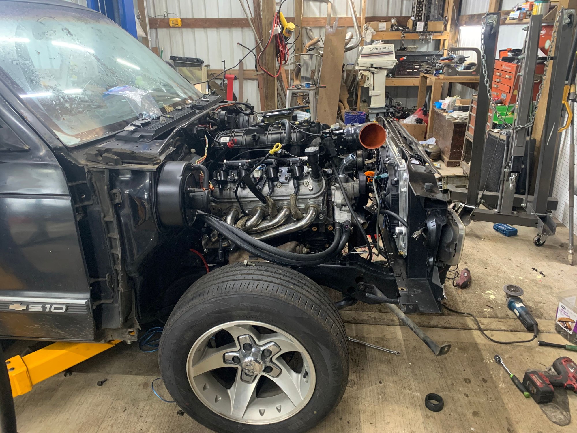

sorry I havent posted much in here. I was slacking then waiting on parts, had to go fishing a few times and handle some apt business bs. anyways I dropped the 5.3l in last night, today got allot of it hooked up, passenger side header and uca have been modded and clearanced. drivers side will get done tomorrow. ebay $23 swap brackets fit great. had to put the gm muscle car pan on it because it was just a really tight fit even with notching the cross member. relocated the battery to under the bed behind the diff. also put a blazer rear sway bar on the truck right before i swapped it and it feels like a huge improvement over no bar.
also for my NPP muffler I hooked up the evap purge solenoid T'd off the vacuum signal (which will have a check valve to accumulate vacuum) I would like to use the shift light to control the evap solenoid as the parameters seem like they would be super easy to setup to control it. the problem Im having is finding which ecu pin to for it. also Im assuming the pcm probably puts a ground signal out when that shift light is turned on unless Im wrong. Ive read the f Body guys say red connector pin 47. if anyone has wired up a shift light from the pcm please chime in.

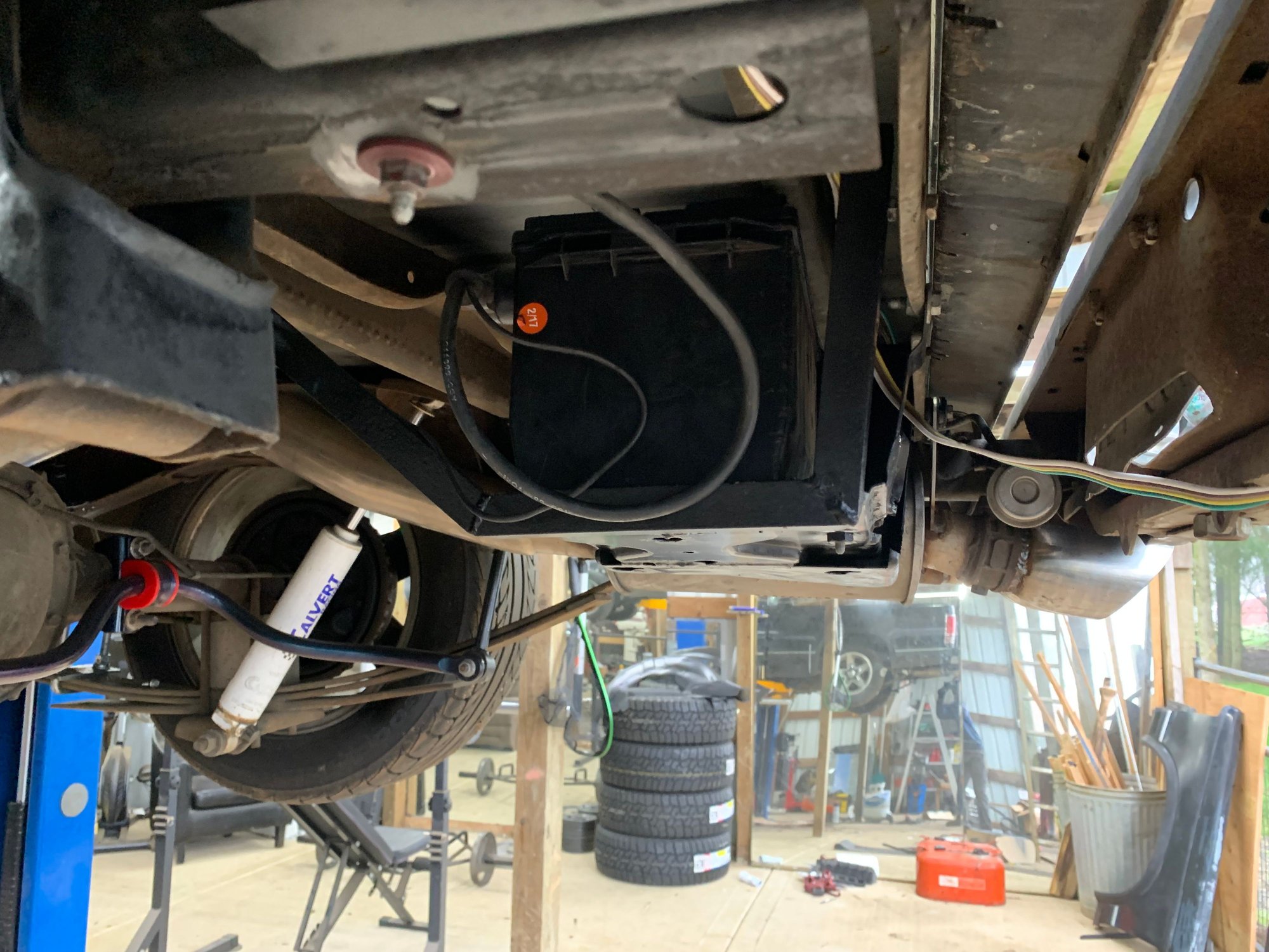

battery box and rear sway pictured.

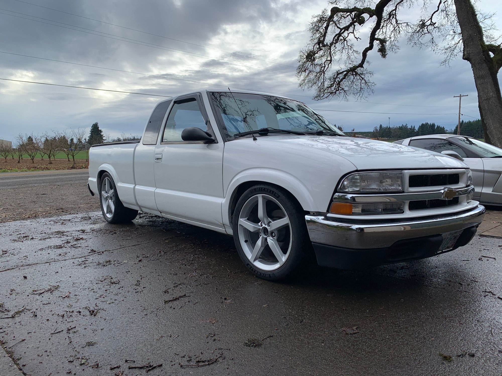

Been slacking a bit on my 91 s10. Found out the collumn shift linkage hits the back of the head and it’s a real bitch to get to with the motor in there. Not sure how I’m gonna go about it but hopefully I can disconnect the linkage from the collumn to modify it. The blue speaker wire is for the evap solenoid I’ll be using to control the exhaust valve.

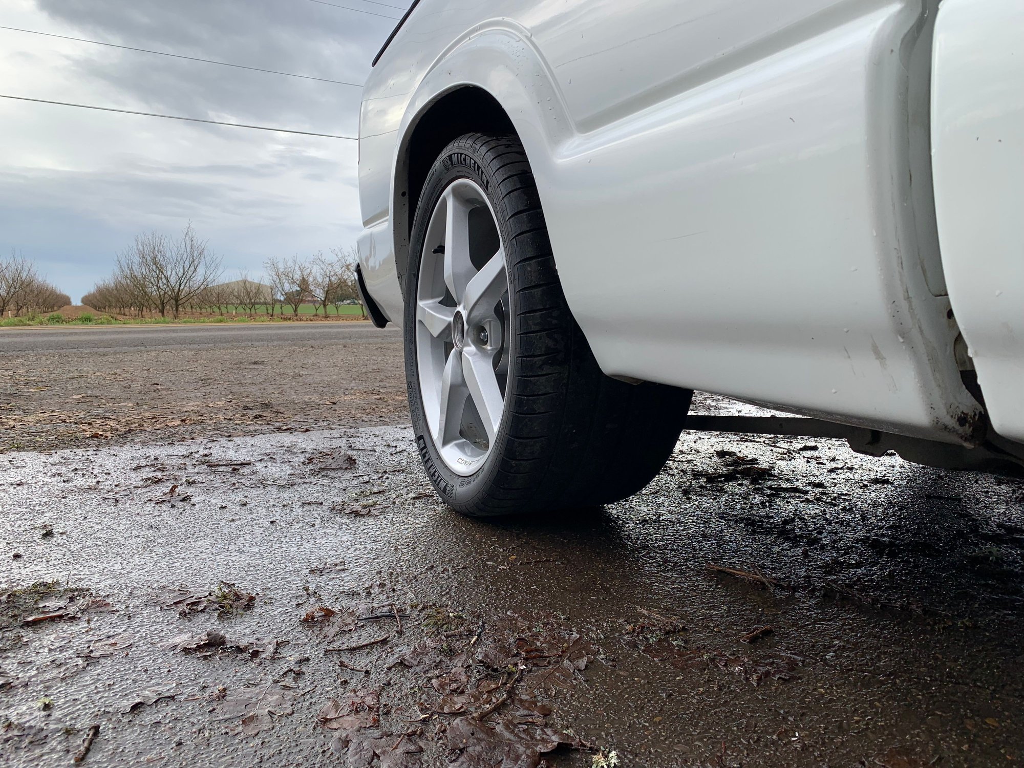

also finally got the wheel spacers I needed to throw my c7 wheels on. I put my old junk tires off my c6 z06 onto them so they are pretty chunky looking on narrow body wheels but they look good on the truck and fit really good after some 2lb sledge hammer finessing. The truck can still fully air down. With 2.5” spacers up front and 3” in the back there’s about 1/4” from the tire to the frame rail.

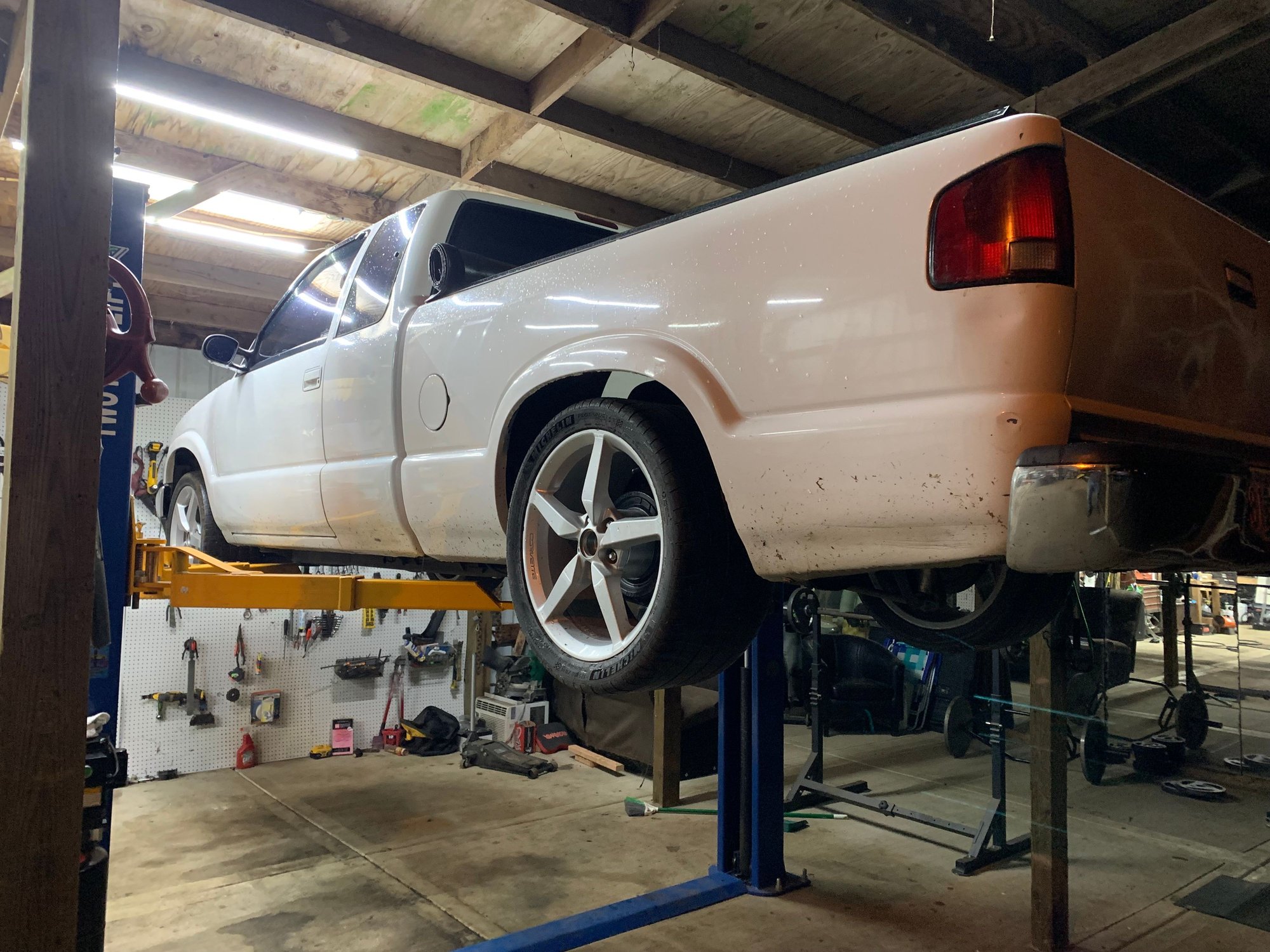

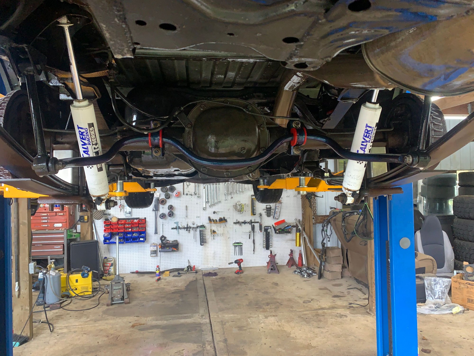

put my 2000 s10 on the lift today. I was told when I got it the carrier bearing on it was shot causing a clunking noise in the rear end on tip in and out of throttle. The carrier bearing looked pretty good and was mostly intact but the lower heims on the 4 link have more play then I’d like and it’s definitely where the noise is coming from. I’m thinking they maybe used a bolt smaller then the heim is so there’s a bunch of slop. Also the exhaust was about 3/4 of the way to falling off down the road so I ended up using a volvo intercooler clamp because I couldn’t find a good 2.25” exhaust clamp for the slip fit. No joke those Volvo hose clamps are impressively strong.
planning on doing a new valve manifold, getting all the air ride stuff leak free. Fitting a rear sway bar and front shocks.

I also shortened up the rear sway bar links so the rear sway will be parallel to the ground when it’s sitting.
