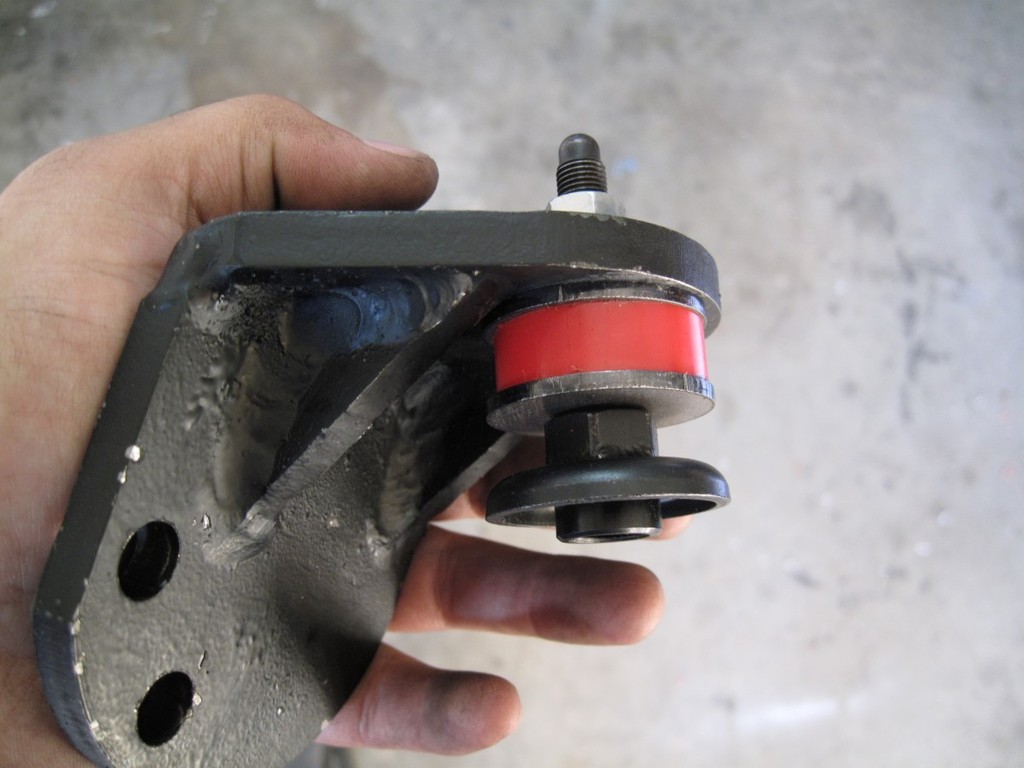

I have been working on a way for guys to go lower or to use a longer shock, and have revisited the stud top option from QA1. I ordered a 1.5" rod of poly and had some custom washers made to support it, and this is the result:
The bushing is a hard material and will not deform under the weight, but will give enough to allow the shock to pivot when the suspension cycles. I used a test piece and put it in my 20ton press and it compressed some, but did not explode or deform, even when I loaded it unevenly. In the uneven loading it bent the washers but did not destroy the bushing, so I feel pretty good about it.
More importantly, doing this takes off 1.5" of distance on the "main measurement". That is additional travel that can be had by using a longer shock, or another 3" of drop at the wheel. So the lowest I think you can go with this will be a 5-6" drop from stock height. This is very low and your cv angles will be very negative and youll probably want to flip the tie rods and get some camber adjusters, but those are easy things if you want to go that low. This is all on stock LCA, UCA, and spindle. My brackets can be used with a drop spindle for even more drop!
I will be selling the bushing kits in combination with the lowers only, or with the full normal kit. I have also updated my spreadsheet to more accurately reflect the possible combinations. I will update the first post in the link in my sig to Purchase 4WD coilover brackets with pricing.
Let me know if you have any questions!
