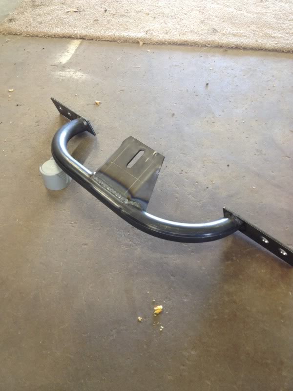

Got the TH400 crossmember done this week. Next is the 03+ 4wd crossmember

Whoa there Atomic, The 03+ cross member you posted looks just like my 2000 2wd EX Cab Coil spring front suspension.
I believe the 99-02 you posted is a 4WD cross member.

The flat offset 99 to like 01-02 I'm not going to be able to do..
