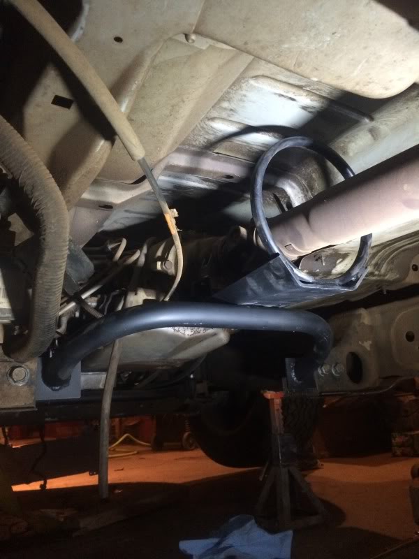

Here's what's coming soon! I'll have 4l80e and 4l60e driveshaft safety loops.

I am in the middle of a tranny swap over myself. Did you ever finish the crossmember of the 03-06 4wd's? If needed I can send you a stock crossmember out of my truck before I modify it?
If you already have them I'm down for one. I just read through the whole thread and I see you said you were starting on them.
Old Mar 31, 2014 | 05:06 AM
  #100
dirt track racer 81's Avatar
iTrader: (45)
Joined: Jun 2005
Posts: 9,439
Likes: 13
From: Hennessey, Oklahoma
Gotta guy sending me his crossmember so I can use it to build a jig for it.
