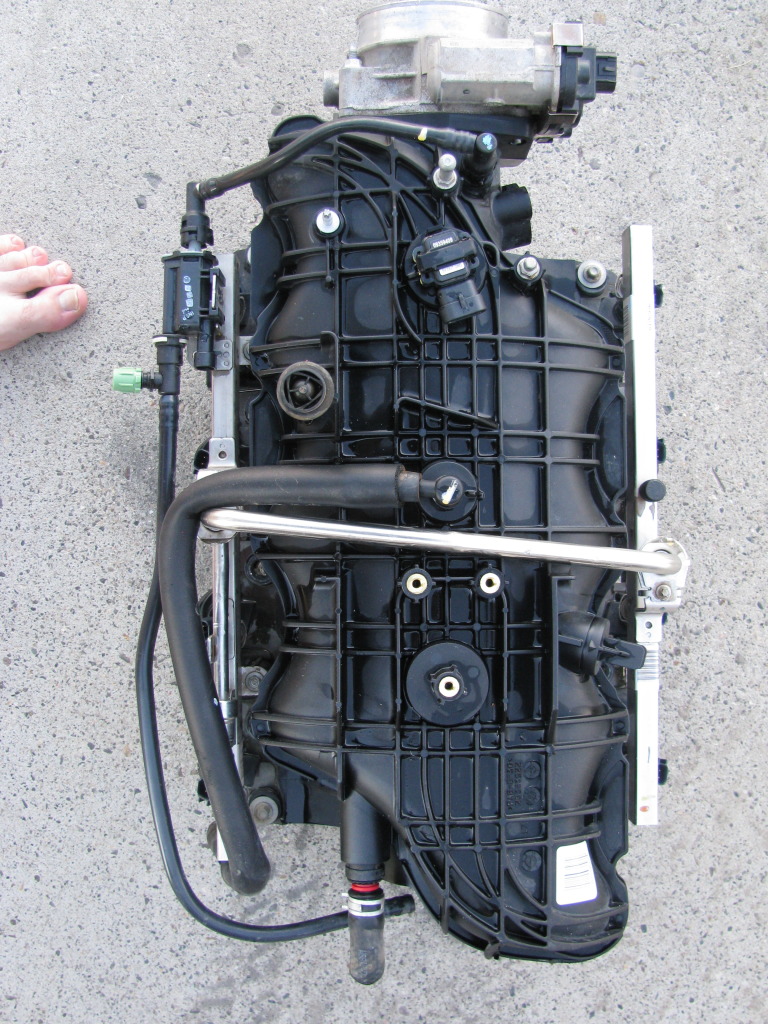

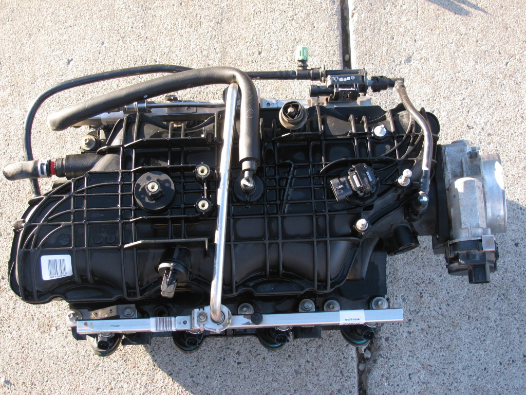

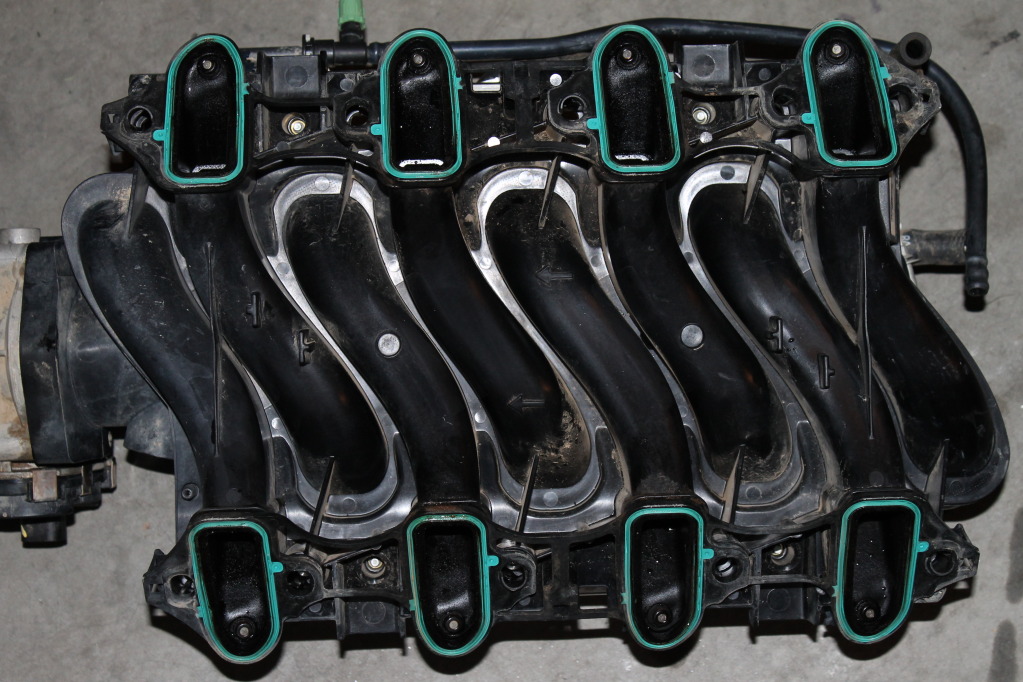

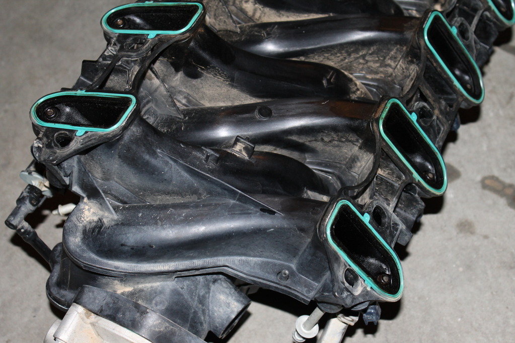

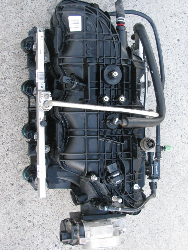

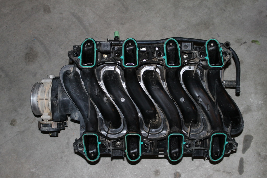

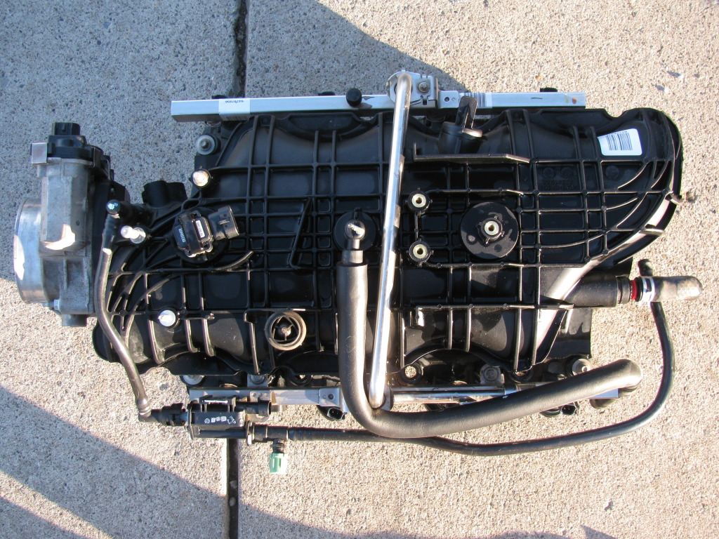

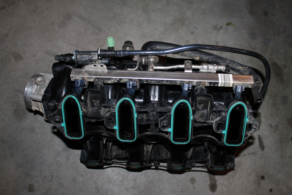

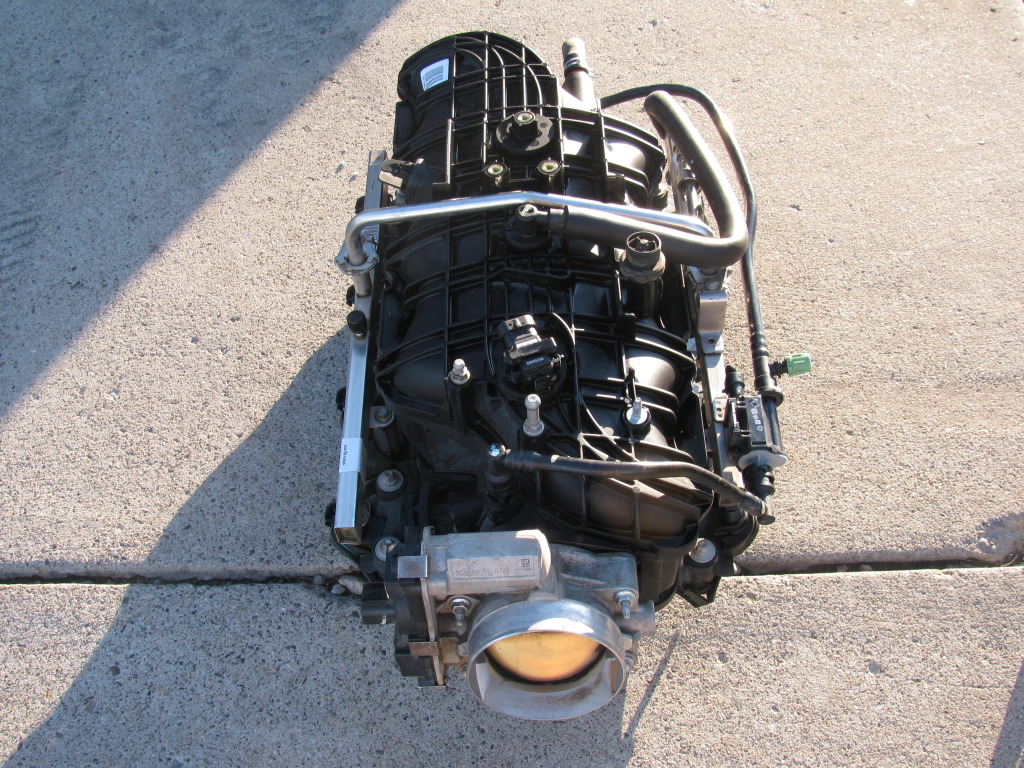

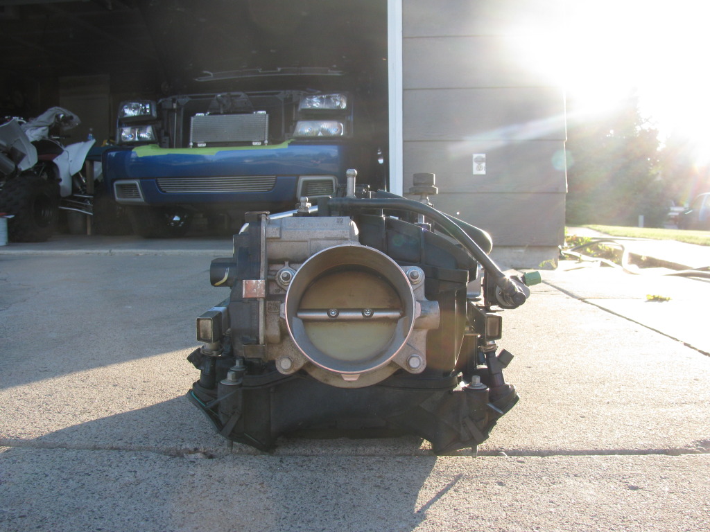

Ok i found this intake manifold and I'm wondering what it is? I have never seen a intake like this.
Next question is it worth putting on my 6.0 that is turboed?

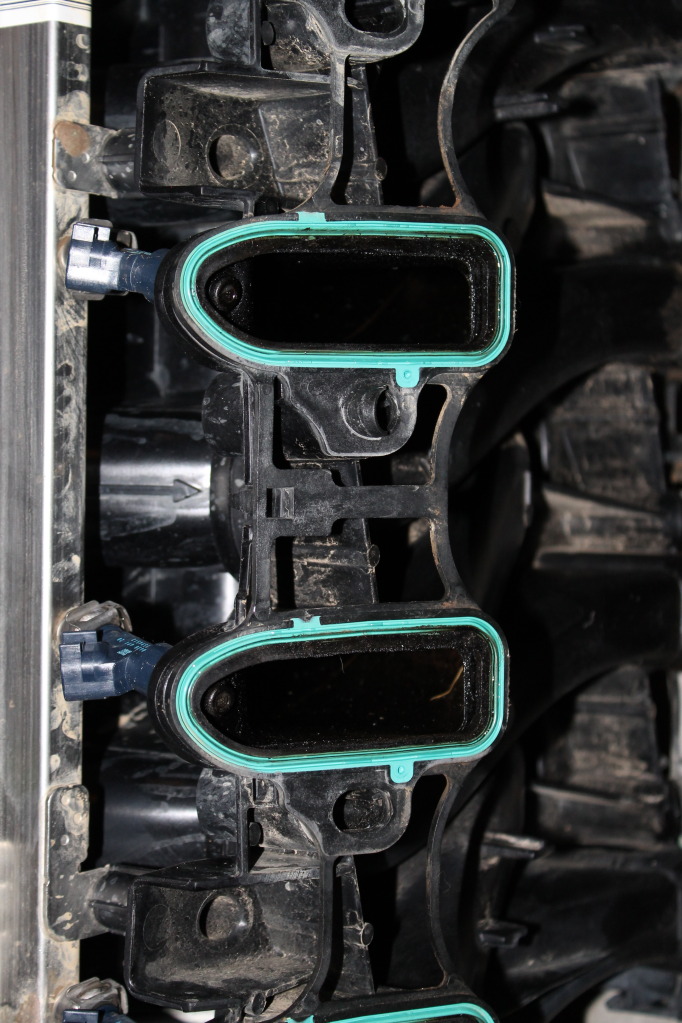

Need Pics of the intake runners.
so under the intake?
Or inside of the manifold?

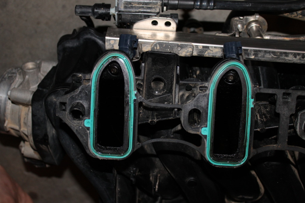

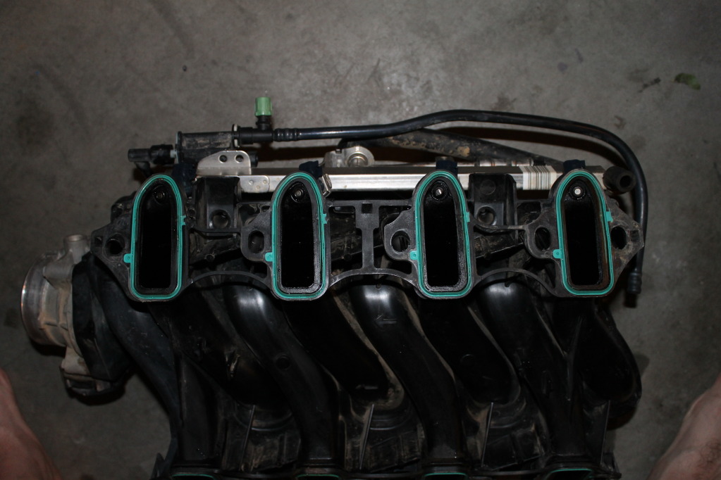

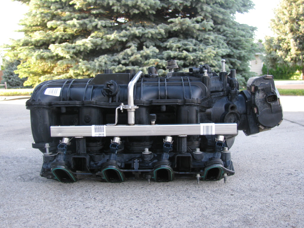

not quite sure what pictures you need but here ya go took more. Name:  IMG_1444.jpg

It's a tbss or a nnbs intake
Im thinking a NNBS? is it any better than a 03 6.0 LQ9 intake? or will it even fit on a set of 317 heads?

It is better no doubt and yes it will fit any cathedral port head
Oh nice. will my factory wiring harness hook up to it or will i need a link or something? i found this intake so im not in it anything.

Yea u will need the Dr. X link for the tb and the intake is a returnless style Idk if Urs is of isn't have to.fond that out also

oh ok gotca. yeah maybe i should just hold off. are these intakes worth anything $$$ wise? if im not going to use it no point in having it sit around and take up space.
