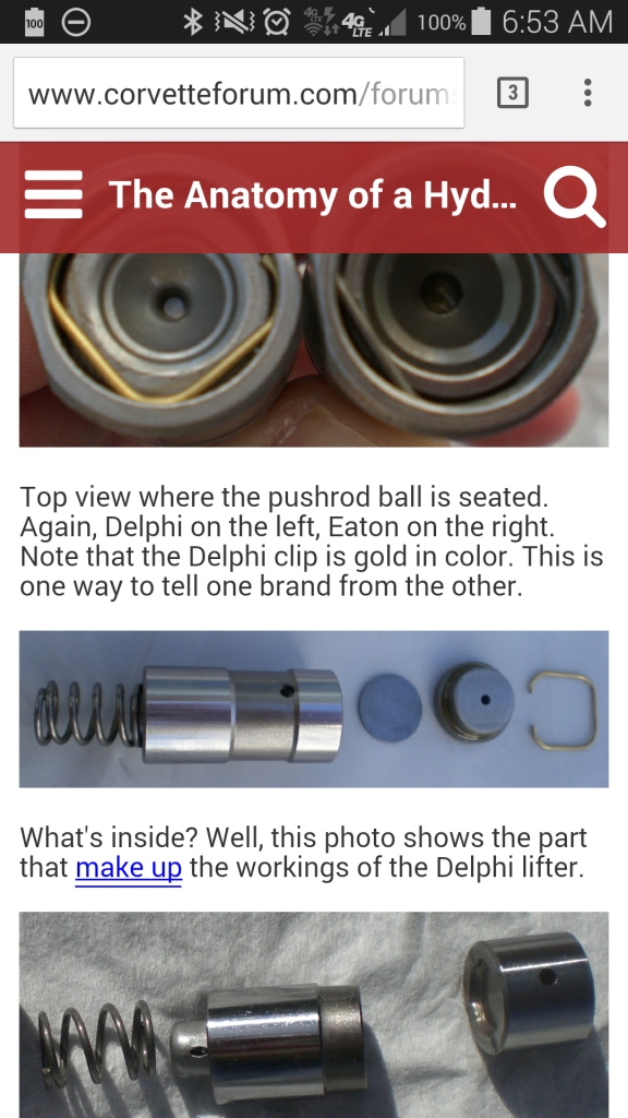

The height of the lifter cup when not preloaded does not matter. It is the preloaded height that you care about. LS7 lifters are now the standard replacement lifter for every LS engine and they are direct replacement. That means you can't assume you need shorter lifters simply because the unloaded lifter cup sits higher. Here's a link to a thread created by a guy who works on these engines at GM. He is more than just a mechanic, likely an engineer but I'm not 100% sure what his position is.
The Anatomy of a Hydraulic Lifter - Corvette Forum

Great article, however the pix will not load...Get the "spinning beach ball" treatment....Old post I guess, and yes, i am a member there as well..Tried to look at the pix by logging in but that didn't help either..
Yes, must be a GM engineer by his replies on the links in the post...
Great info for all....Thanks!

No problem. That pictures load fine for me on my PC and phone
