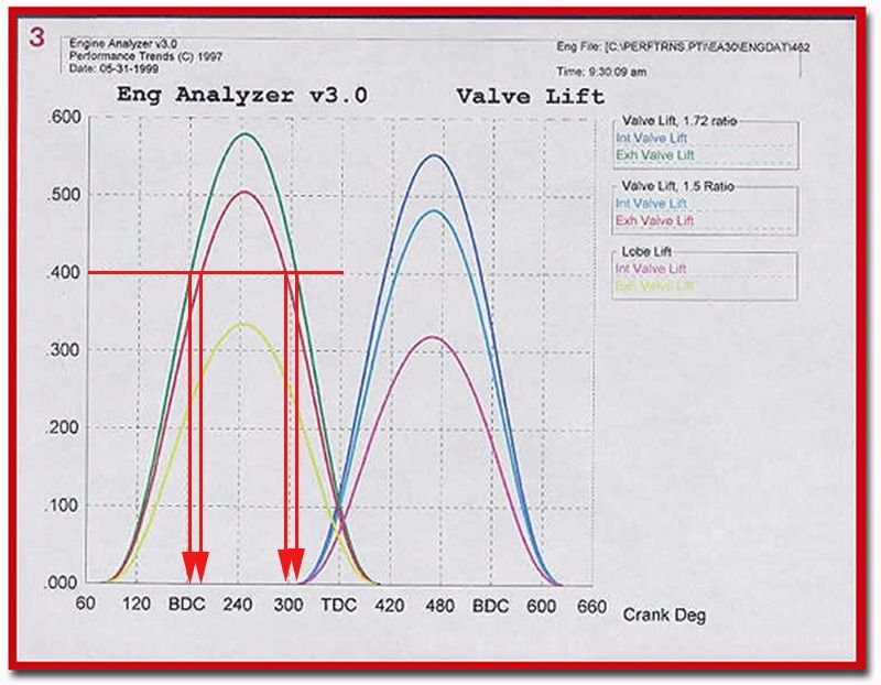

I don't know much about VTT but 1:8 rockers will benefit you in the torque department as they increase the velocity by lifting the valve quicker. Of course there is the benefit of more lift as-well. This is a method used by Roger Vinci who knows much about cams for our heavy trucks. My cam is fairly small: DUR @ .050" 210* / 222*, LIFT .551 /.551, LSA 116* (.585 lift with 1.8 ratio rockers). I use Yella Terra rockers. The heads are L92's with very good double springs and a 2.9L Whipple on top.
