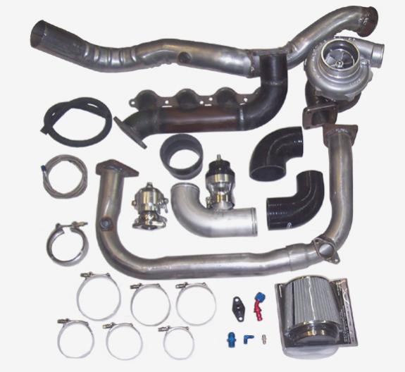

trick stage 1 front mount is $2000
but it doesnt include a intercooler or injectors
your rear mount has potential just need to get a bigger turbo
I would just upgraded turbo on the rear mount and intercool it
BUT HERES FOOD FOR THAUGHT!
Stage 1 Turbo Kit
Stage 1kits comes with aluminized crossover and down pipe. A 70mm turbo and blow off valve are standard. Kit is designed to bolt right in on a 99-06 GM 2 wheel drive truck. Rated at 7psi max.
• 70 mm turbo
• 38 mm gate (vented to atmosphere)
• 44mm blow-off valve
• Aluminized steel crossover and down pipe
• Swept runner thick wall turbo manifold
• Air filter
• Cold pipe with bead rolled ends.
• Silicone couplers and clamps
• Oil pressure and return lines
• Oil pressure and return fittings
• 02 bungs
• washers, bolts and nuts
