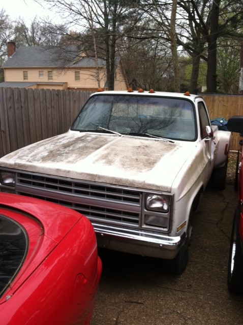

Here is a pic of the soon to be victim. "DONKEY" needs a bath bad. More to come.
