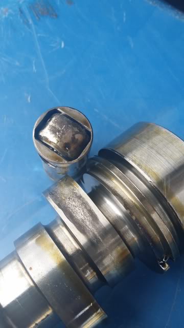

pulled the rest of the lifters and cam and found this. so I have collapsed one lifter and wiped out the bearing on another and took out a cam lobe.
