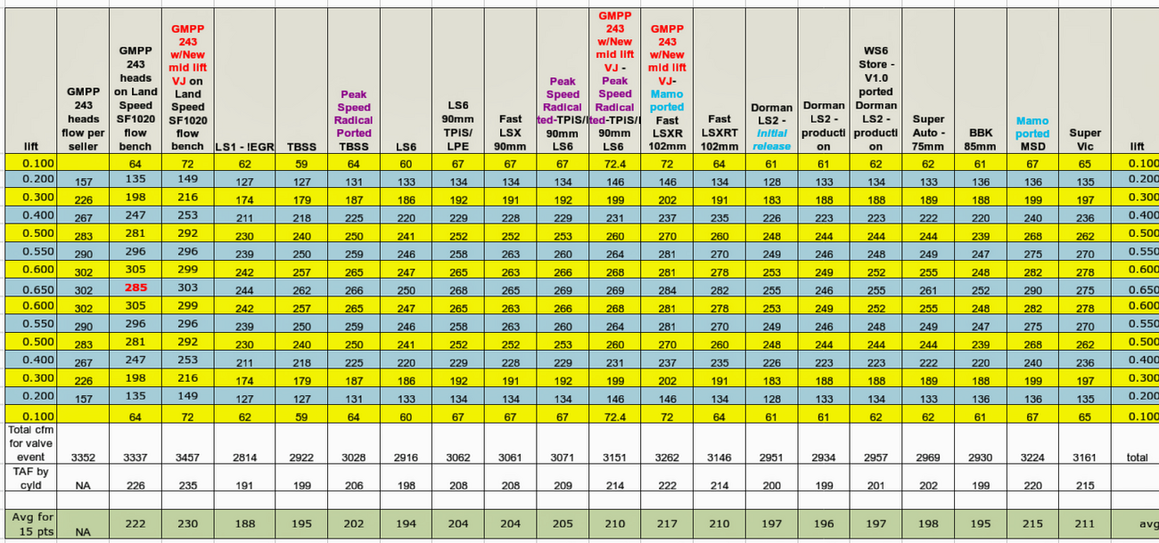

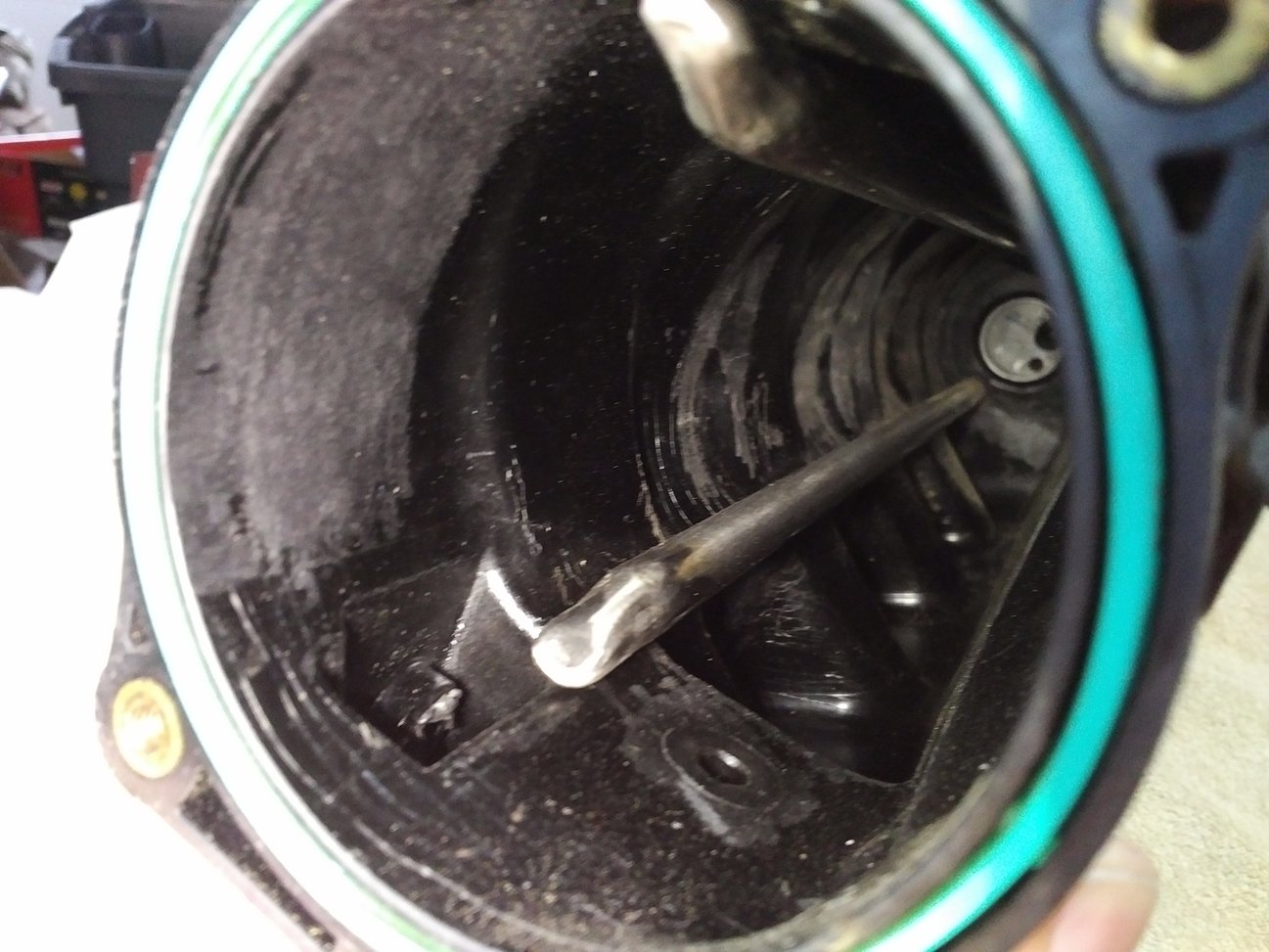

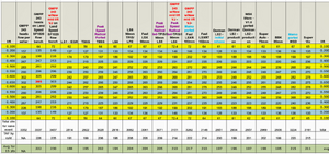

All you ever need to know about LS intake manifolds... the hard work has already been done.
BackBirds Intake Manifold & Cylinder Head Testing Summary
Sample
Rods
