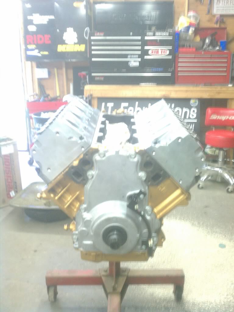

I got problems...I ordered the complete kit
I got the CAM sensor Part number 12596851
The cam sensor feels loose when I put in into the front of the timing cover(shouldnt it be a snug with out tightening it down?). I went over to GM dealership with the VIN from 2011 ZR1 with and LS9 for a cam sensor (part number 1259685) they looked completely different. Once I bought it $68 it was mine to keep not even return for store credit) so I held off. The kit. SO I NEED THE CORRECT part number for the CAM sensor that will work with the kit. I will attempt to contact GMPARTSdirect.com (only thru e-mail) about my situation. ANY help would be awesome!
ALSO have a CAMSHAFT POSITION SENSOR part# 10485432 that just does not work at all. What is the correct one?
Just pissed money out the door. I ordered a decent amount of parts at one time kinda of lost track.
One more rant TSP "DELUXE Engine Gasket Kit" DOES NOT INCLUDE: Oil Pan Gakset, Rear Main Seal (GM Part Number 12633578), & Rear Main seal Gasket (GM Part Number 89060436). If your building an engine shouldn't this be mandatory?
Pics none the less...
Progress...none the less...Oil Pan Gasket is one, ls9 cam is in, timing chain, sprocket in, oil pump, rear main seal, and gasket...cleaned the oil pan and tube out.

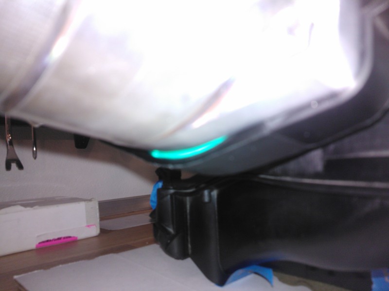

The Nick Williams 92mm doesn't cover the seal completely either on a TBSS intake. I am going to try the edelbrock 90mm since I've seen a couple of people on here use it on their tbss intake swaps.
Pics of what is going on:

Old Aug 11, 2012 | 12:22 PM
  #40
Whippled2dr's Avatar
Joined: Oct 2005
Posts: 353
From: SF Bay Area
Here is a video on youtube showing off the edelbrock throttle. It looks to have enough material on the bottom to cover the seal entirely. You can order this throttle with or without sensors.
