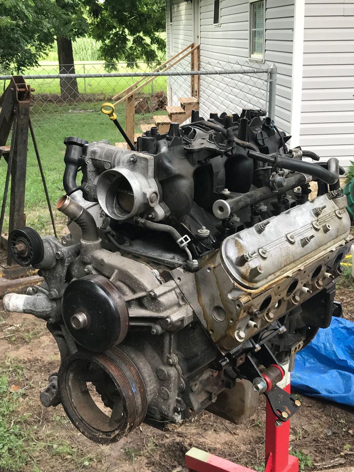

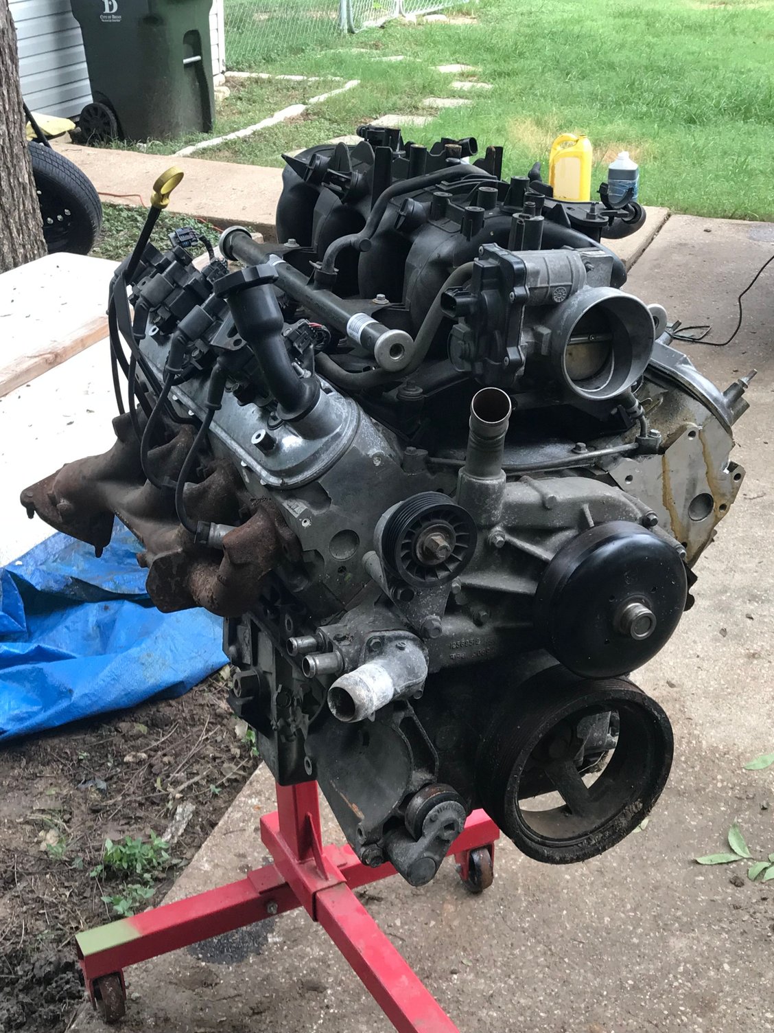

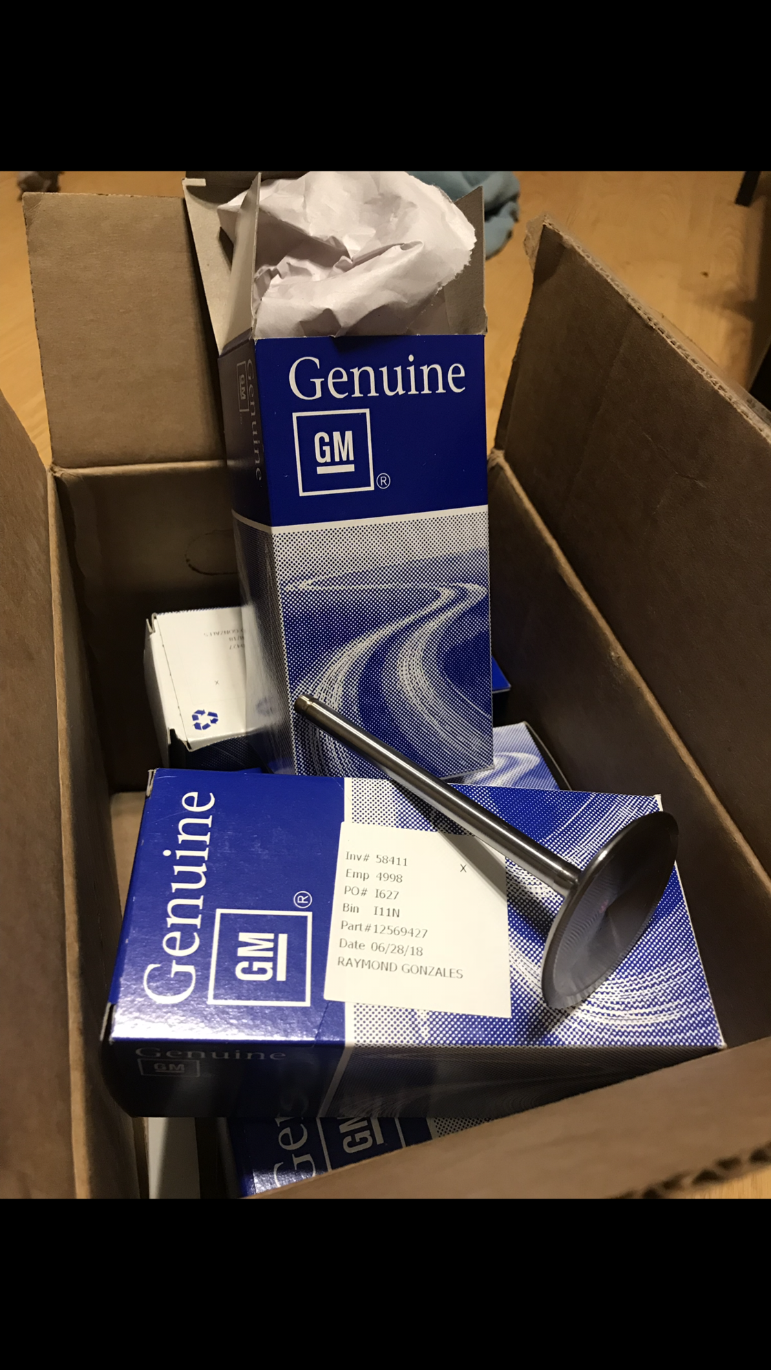

I am LS-Swapping my 86’ C10 Single Cab SWB W/ rebuilt TH400. What I have is a complete 2005 2500HD 6.0 LQ4 Engine, Harness & ECU. Decided to use the stock bottom end & the L92 truck top end. Already picked up a set of Bare L92 823 casting truck heads, L92 truck Intake, & LS3 42lb Injectors. Last week ordered LS3 Hollow Intake Valves, LY6 Inconel Exhaust Valves, Along w/ CompCams Beehive Springs. My parts came in yesterday & I will drop off Monday at the head shop here in town. I want to deck the heads to bump up compression ratio, does anyone know how high of a compression ratio will work fine on 93 pump gas? I was thinking around 10.5:1. From what I’ve found the L92 823 combustion chambers are 71cc. What head gasket &/or thickness? Also I’m considering roller rockers for higher rpm & less friction. I see they offer stock 1.7, 1.72, 1.8, 1.82 & 1.85 ratio roller rockers. I’m worried about PTV clearance. Stock sliding rockers are around $200 & Full Rollers are north of $500 do you think it’s worth the upgade for the cost?
