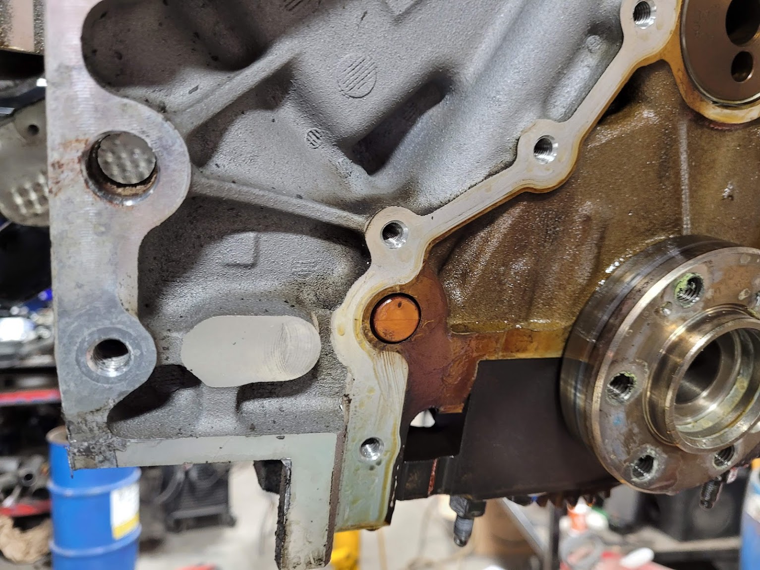

Went to install my new cam, lifters, rear galley plug, oil pump, all the "while I'm in there because I don't want to pull the engine ever again" stuff, and discovered that my truck at some point had a "piston diet mod" unwillingly performed on it. Judging from scans when I first bought the truck to the last scan from 2 months ago, the damage was already there when I bought it. It's never ran like it had a dead cylinder, consumed oil, anything to hint at a ring popping the ring land, so we don't think the D1SC is the cause. It's also the same cylinder that had a broken exhaust bolt which my brother in law thought was causing it to run lean, causing the rings to kiss and decide to say get bent to the ring land.

Leaky galley plug. Was leaking internally and externally. Causes low oil pressure and lifters to fail. No Oring on the side you can see.
New double oring galley plug
