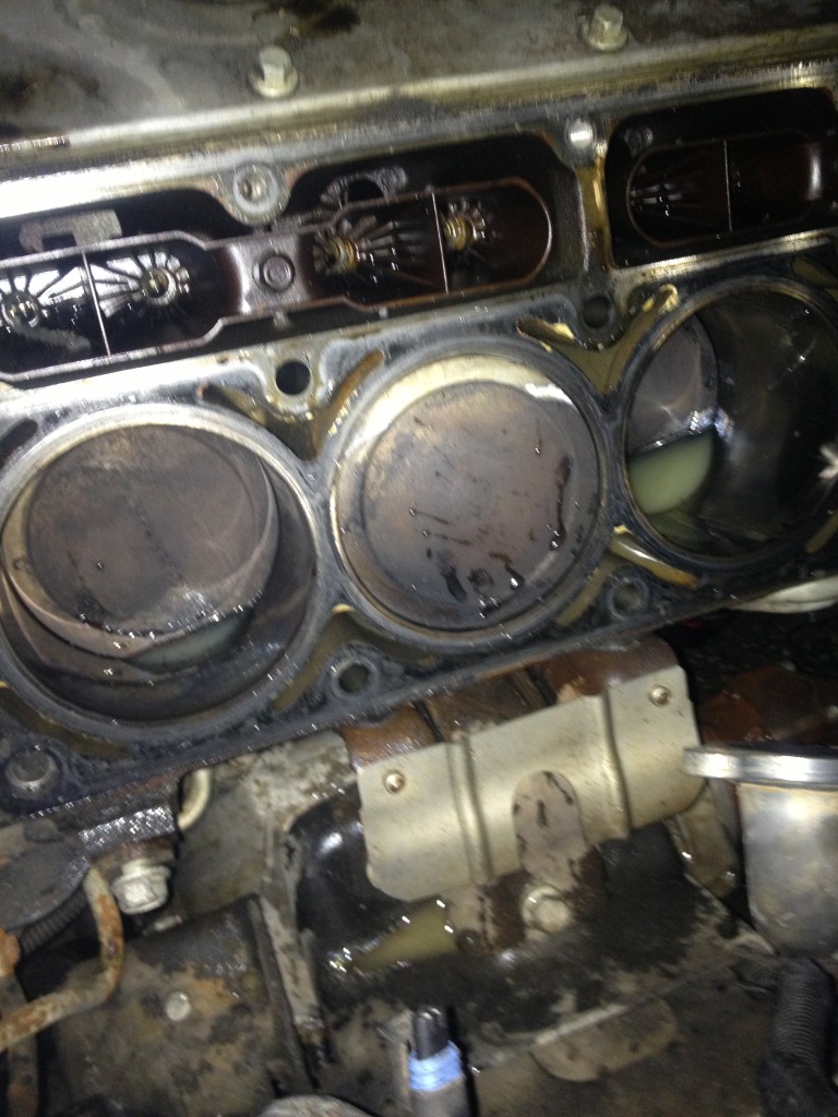

Hello all. Been awhile since I've posted. I still have my truck and its still down. Wondering if I would be able to rebuild the engine or if I have to swap it out for a 5.3L. Here is the only visible damage that I can see so far.

That’s the #3 cylinder. looks like it came out a bit and kissed the head. doesn’t looked cracked or broken. just the carbon rubbed off. I’m thinking that the rod bolts stretched and the piston came up out of the cylinder. if that’s the case would I be able to just replace the rod bolts and go? Does anyone carry stock rod bolts our do I have to go with the ARP ones. It’s going back to mostly stock and no more racing. Will probably sell it so I can get a bigger vehicle for my growing family. Maybe a 05-06 Yukon Denali. I know I have to open up the block to find out for sure. just asking for guidance. I just ordered an engine stand. rotates 360* so it shouldn’t be too hard to take apart.

If the rod bolts stretched, you will need to check the big end of the rod for roundness. Worst case you need to put a rod in it assuming something didn't let go.
Definitely need to tear into it to see what's wrong.

If you're going to sell it, I would just get a junkyard motor. Last thing you want to do is take a chance rebuilding the 6.0 and find it has an issue in the engine after you put it back together. Then you just have to do everything over again.

I agree on the junkyard motor. If one rod **** the bed, chances are others are either damaged or not too far behind. Besides, you will have just as much tied up in parts/machine work as you would a new motor. Besides, if the valve came in contact with the piston, it might be bent. Mine was, but you couldnt tell with a valvespring on it. Only with no spring pressure you cold tell it wouldnt sit flat in the valve seat.

Besides, you can sell what you dont use off the new motor and recoup close to half the cost of the motor

I don't think it's a bent rod. All pistons come up flush with the block. Once I get it out I'll see how they look and go from there
