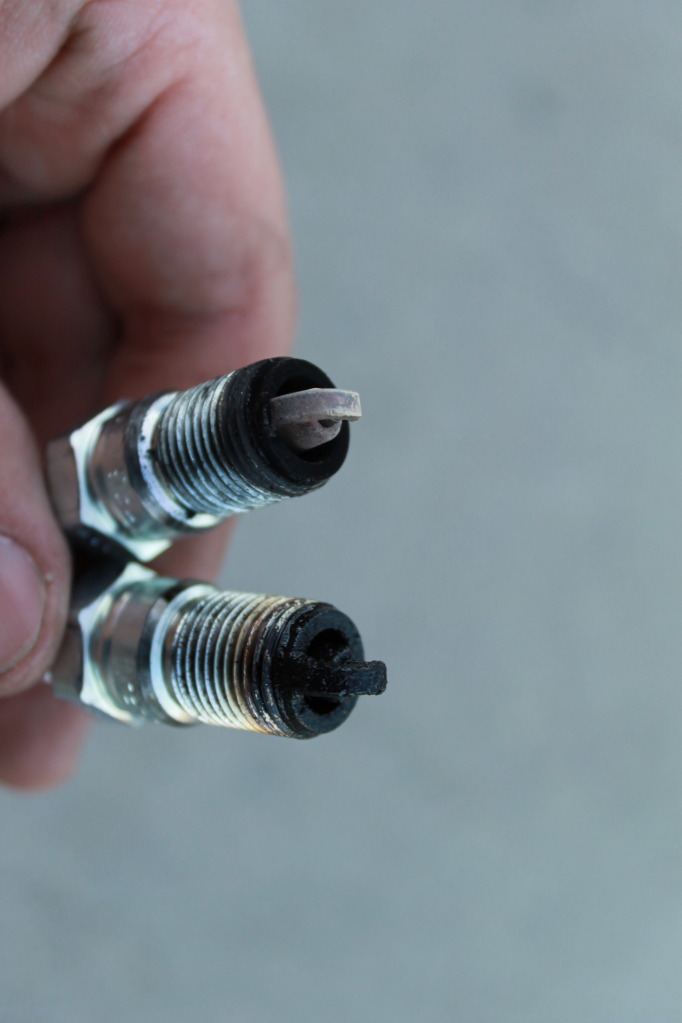

Well i haven't had the SS out in a long time. But today i took it to work for the first time all year. i went to get on it a bit and noticed it was popping a bit when i would go into boost. well after digging around it turnout's out i had 2 burn't up plug wire's. plug wires that were burn't up were 4 & 6. so i replaced those wires and took it for a test drive. well it seemed to be doing fine then all of a sudden. i look out the window in my passenger to look at the exhaust and there was a big cloud of smoke coming from the exhaust pipe. it smokes a little bit at idle. but if you ease into it. it really starts to smoke. if you left off the throttle it lets out a big puff of smoke.

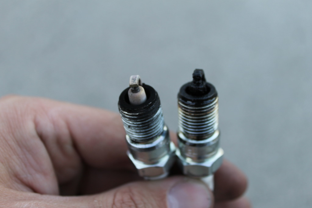

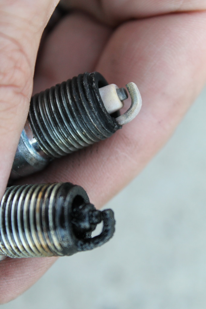

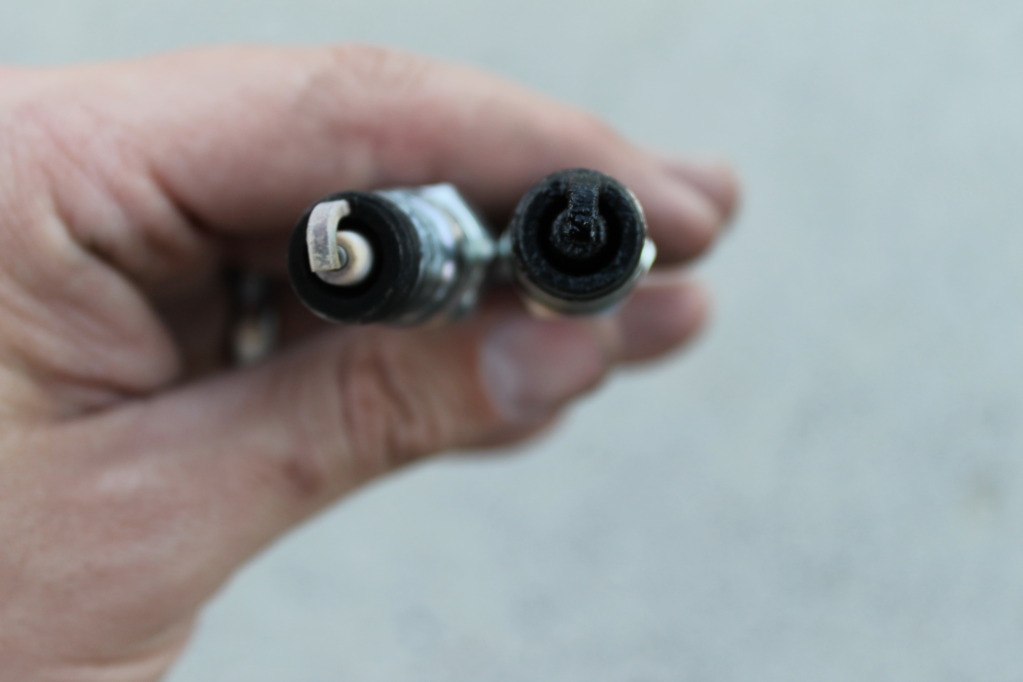

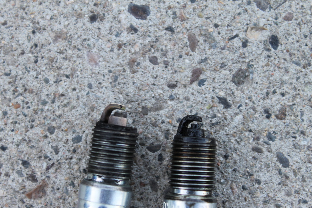

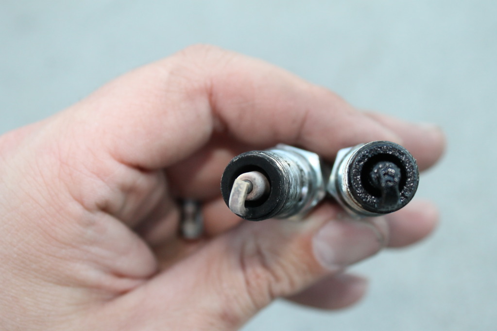

So i went home to pull plugs and checkout whats going on. i started with number #1 cylinder. when i pulled the plug it was covered in black oil and wet. so i pulled #3 cylinder plug. it looks perfect. it was a light brown looked just like it should so i went ahead and did a compression test. On #1 cylinder im getting 160 lbs in that cylinder. which isn't great but i doesn't seem bad either because #3 cylinder in at 180lbs. to me it seems like there should be a lot less compression in #1 sense there is some much oil on that plug.
So what do you guy's think could be going on?
heres a few pictures of the plugs. number 1 plug is on the right number 3 plug is on the left...

If there's oil in the cylinder that will make the compression test read high. So #1 might have even less than 160. If that plug is covered in oil, it didn't just magically appear there. That sucks man. Good luck

yeah im sure thats what is happening because when i removed the compression tester from that cylinder i had to wipe off oil from the head of the tester. im gonna dig into it a bit more today.
i already have another block that is bored and ready to go only missing bearings i have everything else. it a spare.
only thing that is bugging me is that every time something has happen in the past it on cylinder #1. im woundering if i have a dead injector or something
