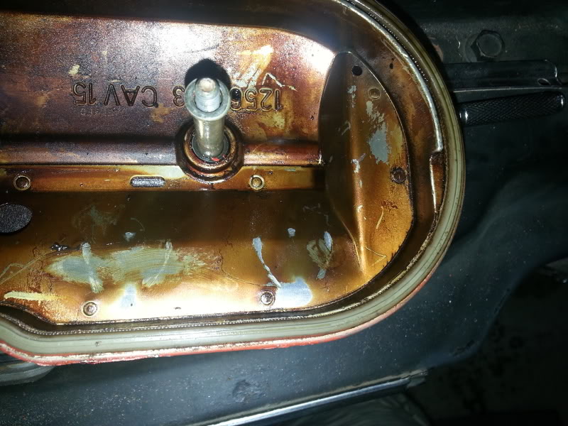

Mine were measured from tip to tip. And they seem crazy short to me. I have installed an 04 z06 cam and milled my 862 heads .025. My thoght was to mill the heads to match up with the shorter base circle cam. I have horrible noise and I just took the pushrods out to see if theu were bent and they measured what seemed short to me.
Also I have what looks like rocker imprints on the bottom of the valve cover. That would make me think my pushrods are too long? And chatter would make me think too short? I have a checker in the mail. This one has me stumped.
