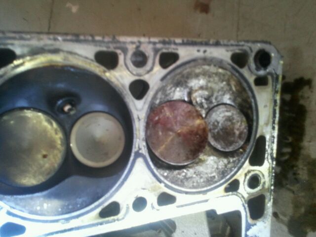

Here are the pics.
Yes that is a crack.
Do you think the head is salvageable?

A local builder/machine shop says they can resleave that cylinder and go from there. It's a pretty reputable shop. I don't like the idea. I like new. Is the resleave that bad of an idea? Also they said the head could be salvaged. It would be a cheaper option.
I was thinking of buying a short block or long block minus the heads from Texas Speed.
