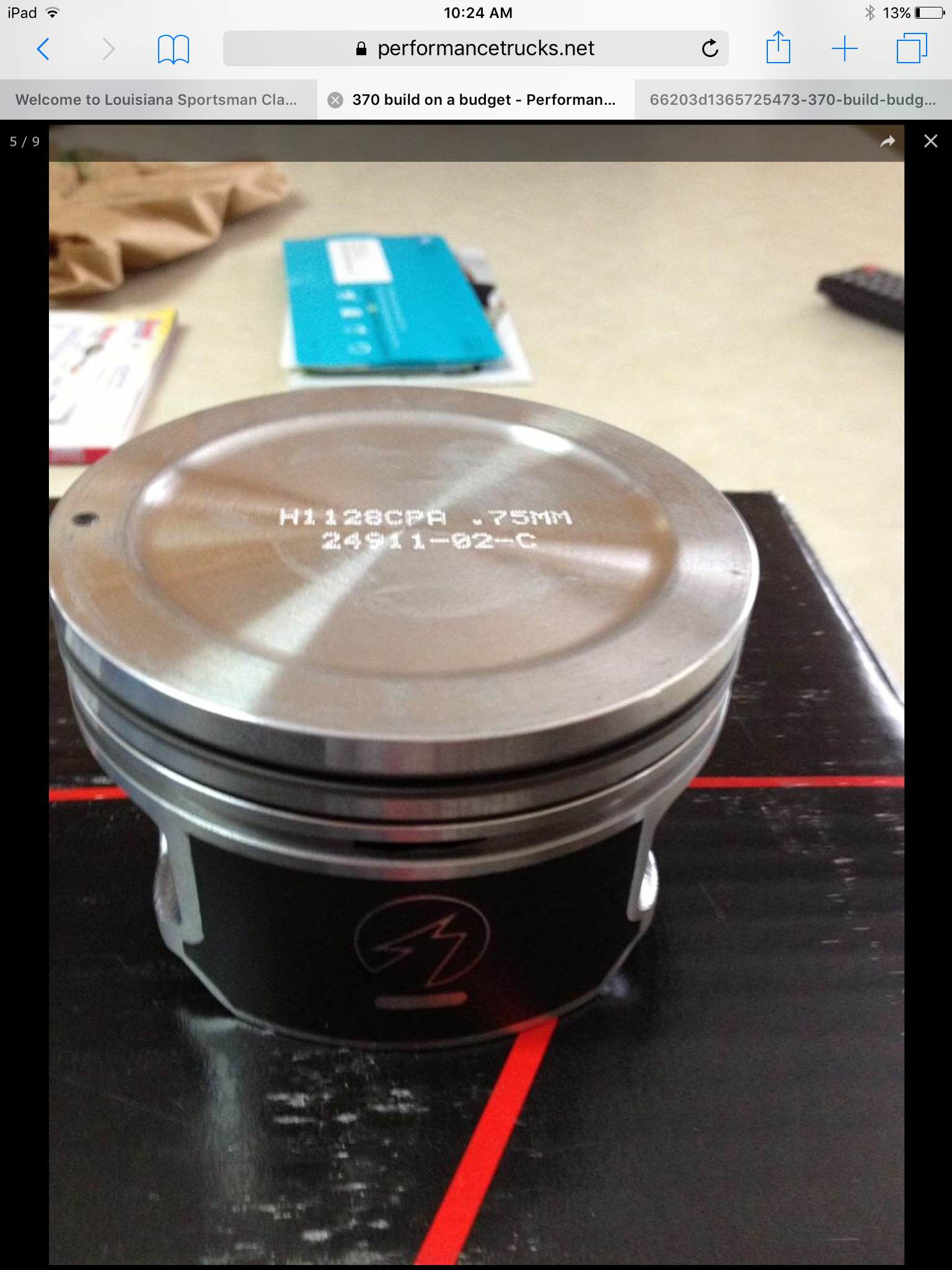

I used speed pro 4.030 pistons part#H1128CT75MM in my budget build. Hyperutectic piston with coated skirts. Not forged anything special but a good replacement for $250 .
Great for a mild build

The ones I listed are stock replacement and stock compression. They have a slight dish just like the factory piston .
Attached Thumbnails Help needed with choosing pistons for my 6.0L-img_0017.png
My stock pistons have a dish like the one you have pictured but with two valve reliefs. Is the valve relief for vvt engines. I'm doing away with the vvt
