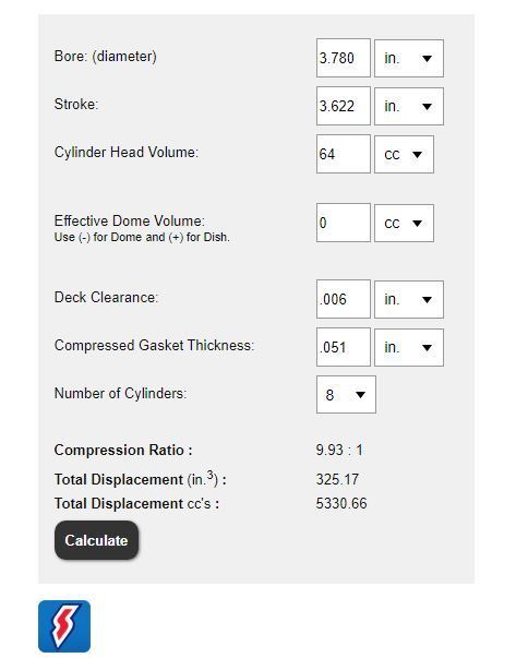

On a L33 factory 5.3L with flat tops with 243 head your about 9.93:1 compression.

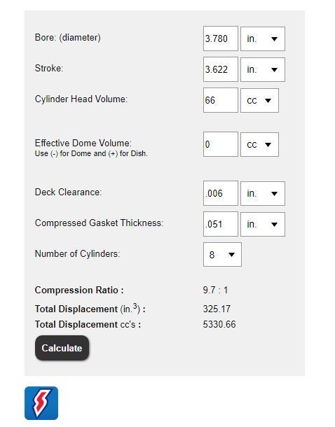

So if you ran the 241 there like a 66cc vs 64cc so it will only drop to about 9.7:1

It's all relative and you would need to physically measure to verify true compression ratio. but this is a pretty close idea.
L33 Stock
L33 W/241
