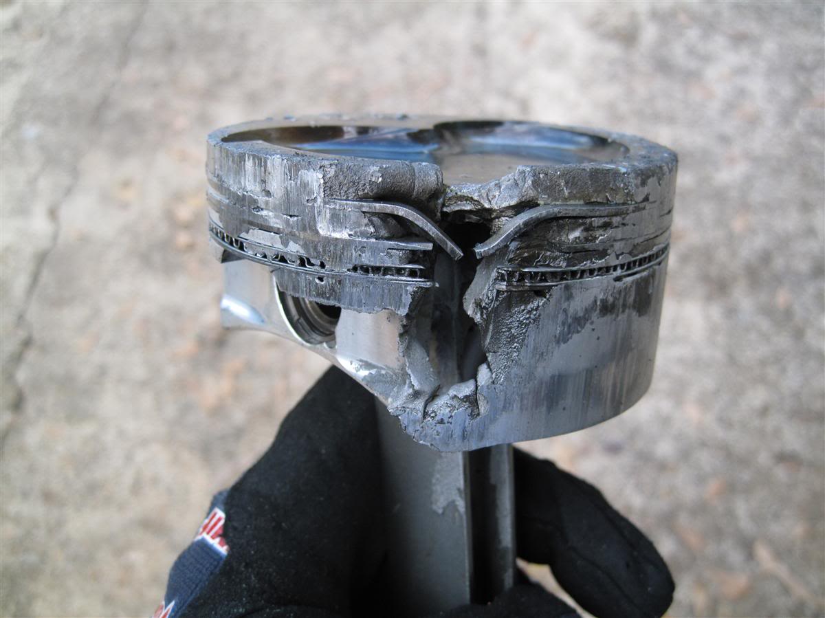

Forged engines arent indestructible either, case in point:
This was with less boost, and less timing than I run now on my current setup, but there is more than that that goes into a good working engine. As everyone else said, find a good, no, GREAT tuner, that has done FI LS engines before.
Old Jun 24, 2012 | 11:28 PM
ak2007r6's Avatar
Joined: Aug 2011
Posts: 4,104
From: Alaska
holy **** man. how did the block look after that

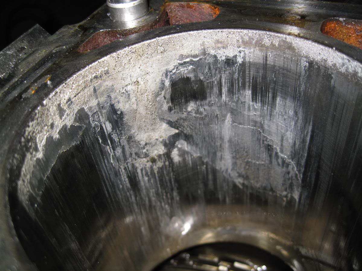

Old Jun 24, 2012 | 11:32 PM
Atomic's Avatar
I have a gauge for that
Posts: 16,282
Likes: 438
The other 7 looked fine, but the block was trashed so I had to get a new block for my current 402.
