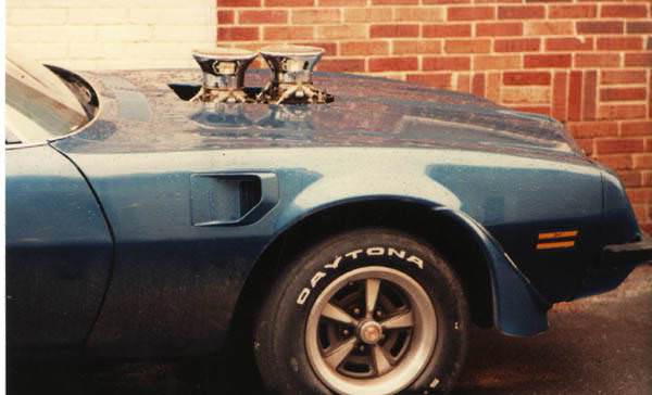

You sound a lot like me. Back in the mid 80's I had a 1975 T/A I bought for $500. Came across a super deal on a fresh sbc built by "Jungle of Belmont" strictly for drag racing. HUGE Crane solid cam, Sharp roller rockers, stud girdle, 12.5 forged, pink rods, slant plug 292 turbo nascar heads (odd name as no turbos were used), MSD, Edelbrock Tunnel Ram with two 650 double pumpers, TH400, 3000 stall, 4.56 gears, True Hooker Headers/Side Pipes made for the Camaro's etc.
I daily drove that beast for one summer and was SO HAPPY when I pulled the motor for a 55 chevy project and sold the T/A. Dad had a 1967 Impala 283 powerglide he handed down to me. It was heaven driving it after driving the T/A all summer lol. The truth is I had gotten into a little trouble with the T/A (racing). My lawyers worked it out if I'd sell the T/A I'd be able keep my license.
