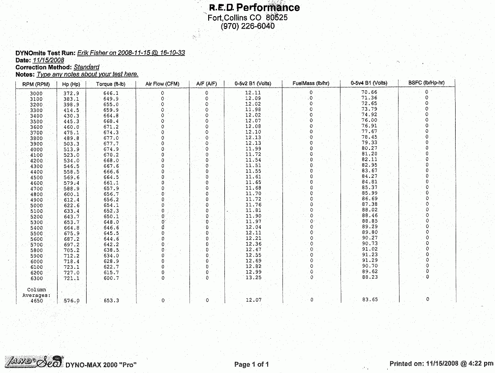

Here is the dyno graph for the cam I used in a 408 with a TVS 1900 on top. Trucks need torque to get the mass moving. I have a great idle sound like you want, very good daily driver, at 226-238, 601-601, 114 LSA. I am confused why people recomend a N/A cam in a blown application. Call a good engine builder that has done a lot of FI for your application. Every build is different depend on heads, values, rockers, compression, exhaust, etc,,, One off the shelf will work but may not best for your application. Don't be afraid to go bigger, you will get your idle and more power depending on your build, but you must consider whether your engine flows enough air to support your cam choice.
Sounds like a lot of power for only 5psi. Im curious to see what kind of 1/4 mile these blowers will turn on boost only. Alot of people use the wrong correction factor on FI engines in Co. Forced induction still takes a hit up at elevation but only uses half the correction factor. If you are making 727HP in Co at 5psi that is massive power. At 12psi my little 6.0L with the T76 @13PSI only made 712HP, but my truck has ran 10's at Bandimere boost only. If you are making more power than that with a TVS 1900 Im really interested.

Stock 48: Thanks for the complement, my builder has worked in Colorado for years so I am sure the correction on the dyno was accurate. He has routinely entered the Engine Masters competition in New York and feels very comfortable correcting for altitude. You are making great power on that 6.0litre, I am sure that my pig of a truck can't keep up. We might bring it to Bandimere this summer, I will PM you if we do, I would like to meet. You obviously dialed in great power with a smaller cam, what kind of ft/tq do you make?
