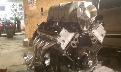

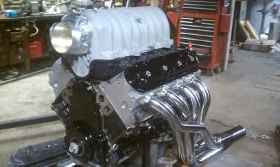

here ya go guys figure i throw up a few pics of my motor
big thanks to stewart (txsilverado)

Whats it doing not sitting in an engine bay?

putting on the front drop and then it should be sitting in there this weekend

Nice engine man. I like that 3 wheeler back in your garage too, big red.

Holy Chit, I never realized how ungodly big the FAST manifolds are ! link to build specs ?

that looks nice man, should run really well in your truck also

Thanks man. And that big red is a beast lol

I never made a build thread but its a iron 408 11.4ish cr 247/255 .632/.632 112+4 243 heads hand ported to 236cc's of coarse the lsxrt 102/102 tsp 1 7/8 f body headers will be into 3" duals with round dynomax ultraflo mufflers oh and an airaid Cai efans

I'm hoping so. Hoping for deep 11s

is it running yet? that intake is retardedly huge! lol. hopefully that cam plays nice with it. it was ground for the ported LS1 fast. i like how it still says my name on the head. is it too late to change my mind on selling this motor?
