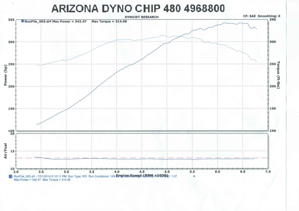

Well tomorrows the big day! Time to see what my money, blood, and sweat has done to this thing LOL!
Dyno is for 4pm and here in Phoenix it will be around 110* and it's monsoon time so there will be some humidity, hopefully that won't bring down numbers too much. And yes I know dyno is just a tuning tool and it's just a number, but won't be out to the track till at least fall so I'd like some sort paper giving me a pat on the back now haha!!
Stay tuned!! (Pun intended lol)
#27
This was on a 2nd gear pull, converter locked. I'm told 3rd gear pulls add +20-30 rwhp. They didn't want any mishaps with the driveshaft so went with 2nd.
Hard to see but temp was 109 and humidity 11%
I'm not to hung up on the numbers though, the thing runs night and day difference! I guess in my previous tune the timing was all out of wack and AFs all over the place. Shift points set to 6700.
#28
