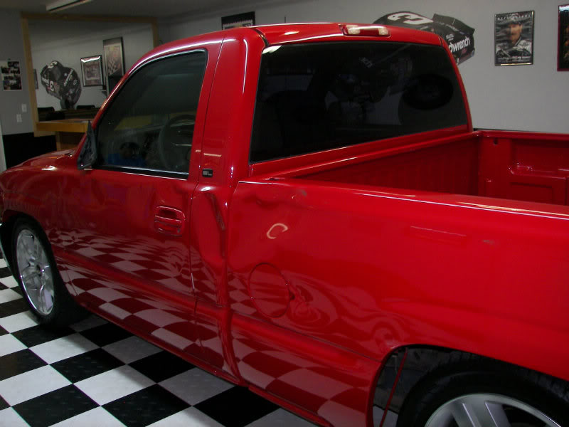

About 8 years ago a deer slammed into the drivers front fender and took everything out along the sides. Windshield, mirror, door skin, cab behind the door and bedside. The damage was over 5 grand and I was luck they didn't total me out then... even got a rental... a new Dodge Dakota
