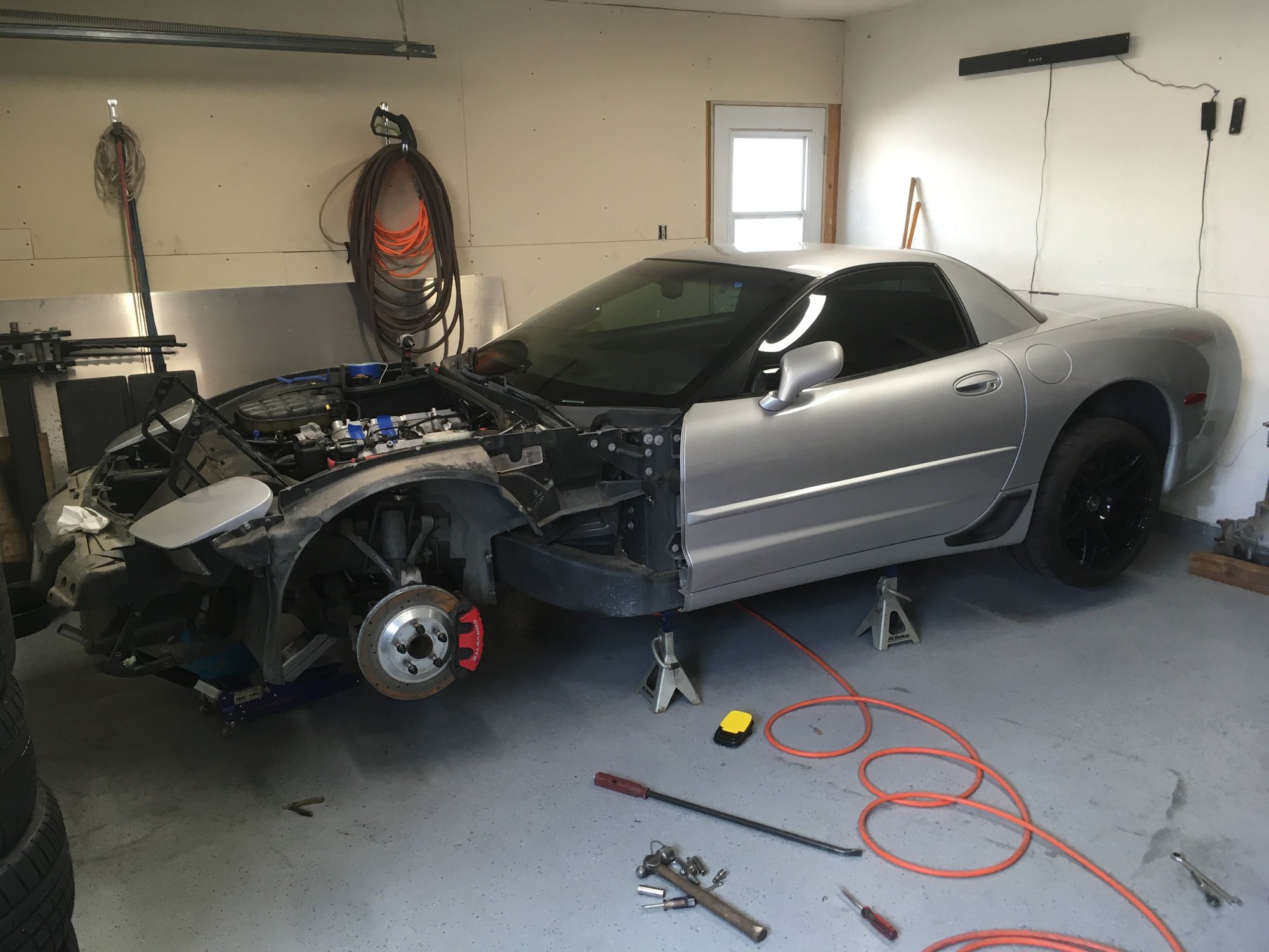

I have my C5 Z06 damn near a bare body in the exact same space. If you're smart and organized, anything is possible
Ive built my MR2, Tahoe, C5 and most of my Toyota Crawler in this space. Yeah it's small and it's sketchy sometimes, but it works
